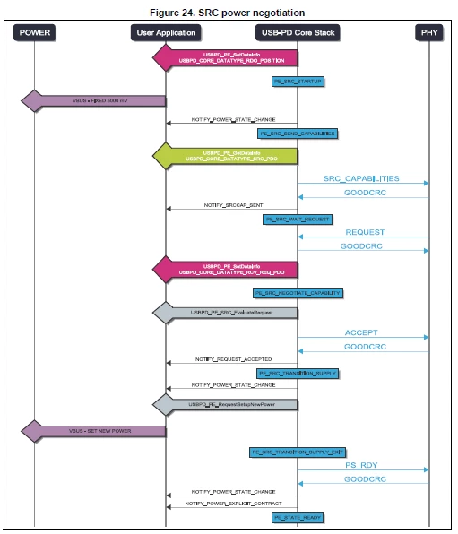

Hi Stmteam,
I am using Stm32G081RB to Develop Source application.
please have a look at the source files and trace.
Note : trace file is from sink device attached to the Source Device currently we are looking to Develop complete solution.
Questions:
- we couldn't see the PS_RDY msg from source device after the Power Setting across the VBUS. is there any timings to be met for Power establishment after Port negotiation with connected port partner?
Note : ADC reading after the power establishment is proper. I make sure the voltage read by the USBPD stack is correct by putting break point at BSP_PWR_VBUSGetVoltage in usbpd_pwr_user.c file.
