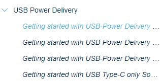

Feb 22, 2024 3:33 PM UTC
I would like to add, in USB PD wiki we have 4 step by step useful examples for different modes if interested.
To give better visibility on the answered topics, please click on "Best answer" on the reply which solved your issue or answered your question.Best regards,FBL
