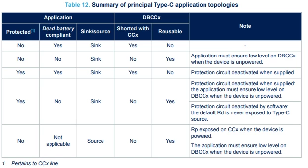

USB PD Dead Battery pin usage when functioning as PD Source
I am using the STM32G071GBU6N to implement 2 USB PD interfaces. Port 1 will be sink, Port 2 will be source. On the sink interface, the dead battery support is needed and DBCC pins will be connected to cc pins. On the source, I do not need dead battery support. I want to reuse the DBCC pins for other use. The ref manual indicates that they should be connected to ground. Is this necessary, or can they be reused when operating as source only?

If dead battery resistance is not desired (the case for a SRC) the DBCC pins must be at GND on power-up and until such time as the UCPDx_STROBE bits in SYSCFG_CFGR1 have been written. The recommended way to do this is shorting the pins to GND (as described in AN5225). However if re-use of DBCC pins as a GPIO is needed, it is possible after the write to UCPDx_STROBE bits has been done. In this case, an external pull-down resistor to GND (say 100 kohms to 1 Mohms) should be present on the DBCC pins to help guarantee a clean GND state at start-up.

OlivierR
Jan 27, 2022 7:53 AM UTC
In AN5225 - Rev 5, there is a chapter describing DBCCx usages from system point of view:
11.2.1 DBCC1 and DBCC2 lines
Have a look in following table:
Table 12. Summary of principal Type-C application topologies
0693W00000JNUoIQAX.pngregards.
