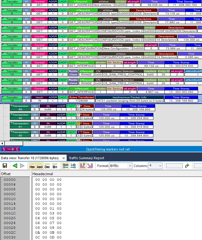

USB microphone to H743 host streams mic then data freezes
Connected an USB microphone to an H743 as host and it streams mic audio perfectly at 48 KHz for around 5 seconds then the data freezes.
SOF is still being called as is AudioHost_IsoDataReadyISR() from the STM IRQ driver, DMA is running (its set to use DMA, I tried without but same behaviour), but the same 96 bytes are transfered every uS: I can clear the receive buffer but it gets refilled with the same data.  Attempts to re-init the pipes etc etc fail to restore streaming.
Also, any pause in the servicing of the call to AudioHost_IsoDataReadyISR() results in exactly the same repeat data arriving.
This is my own code based on STM’s examples, as I said it runs perfectly for many seconds, if I unplug the microphone it runs again when plugged back in for the same good few seconds.
Is there an approved way to restore audio streaming without a full reset when there is an occasional timing glitch in servicing the AudioHost_IsoDataReadyISR() call?

Hi thanks for your reply.  We did find that around when it froze a couple of times there was an BLERR or TXERR error detected in the STM driver that then called (void)USB_HC_Halt(hhcd->Instance, chnum);, but we just could NOT restart the channel using any known method apart from replugging the USB mic.
Later we found that the freeze occurs even when there are no errors or calls to (void)USB_HC_Halt(hhcd->Instance, chnum);,   and everything keeps workin, SOF and Notify calls, so its hard to know why this repeat of the last packet is occuring.
We disabed the .DMA on the channel, and the same freeze occurs under software transfer of frames.
What we do see on the oscilloscope which is monitoring a GPIO line toggled in AudioHost_IsoDataReadyISR() IRQ handler call, is a stable looking 1ms between calls, with a very slight occasional jitter.
The receiver buffer is just one buffer, it gets unloaded on the AudioHost_IsoDataReadyISR callback, so not sure how that could affect behaviour.

Hi ​@Robmar
As I could not reproduce the issue on my side, we need to narrow it down methodically.
At this stage, the symptom could still be related to:
  • packet size / frame alignment
  • host service latency
  • state recovery in your custom audio receive path: AudioHost_IsoDataReadyISR()
Since you already observed a slight timing jitter before the freeze, that could be a useful clue.
  • If the issue appears reliably after a certain delay, the stream is likely service latency sensitive.
  • If it appears even with a completely idle CPU, the issue is less likely to be caused by scheduling load.
Try a different audio format, for example 32 kHz, to see whether the issue disappears or changes behavior.
That would point more toward a USB audio packet alignment / stream handling issue than a general device failure.
It would be helpful to provide a USB trace at least covering:
  • the moment before the freeze
  • the freeze itself
  • errors/debug log and halt

That’s great news if you got host USB microphone streaming, can you send me a copy of the code to test on our board?
Adding the ISO IN streaming is so little code, I’m surprised it wasn’t included with STM’s HOST USB example which only handles a speaker output, with the mic side left missing just a dozen lines of code.
If you haven’t tested it at STM, I’m going to think there is a serious bug in the STM USB controller!
When the freeze in the audio IN stream data occurs there is no error at all, there were a couple of instances of BLERR and TXERR, but this freeze occurs 99% of the time with no error bits or interrupts at all.  The whole USB engine keeps working as if nothing is wrong, but the same frame is copied to the buffer each 1ms period, timing is perfect viewed on the scope, and with our without DMA enabled on the USB, it does the same.
Anyway, a little progress here, I have a reset routine that recover the mic without unplpugging it, but it takes 3 seconds to recover which is unuseable.
This code indicates that a channel gets blocked causing the audio IN stream to freeze:

In the H743VIT6 revision V errata sheet, ES0392 - Rev 15, it lists a bug in the USB controller similar to what I am seeing:-
2.25.4 Isochronous IN EP disabled when packet fetch is in progress Description In Buffer DMA mode, when an isochronous IN endpoint is disabled and re-enabled, it is possible that the data transferred on the USB bus for the isochronous transfer is from the previous transfer on the same endpoint. This issue can occur if the DMA packet fetch from system memory is pending at the time of the disable operation. Workaround 1. Set the following bit in the DIEPCTLx register for the endpoint to be disabled: DIEPCTLx.EPDIS. 2. Wait for one packet fetch time on the AHB bus. By this time, if an ongoing DMA transfer for this endpoint is completed, new DMA transfers for this endpoint are no longer initiated. 3. The application must set the endpoint into NAK mode (DIEPCTLx.SNAK=1). See the section Setting IN endpoint NAK. 4. Wait for DIEPINTx.INEPNE (NAK effective interrupt). 5. Set the following bit in the DIEPCTLx register for the endpoint to be disabled: DIEPCTLx.EPDIS
In my case, this also seems to happen with the DMA disabled and software copy.  I am NOT using D-Cache.

On my side, I tested USB Host Audio streaming using two STM32H7 boards:
  • one STM32H7 acting as the USB microphone device, sending a known incrementing pattern
  • the other STM32H7 acting as the USB host
The host receives the pattern correctly, which lets me verify both data continuity and payload integrity.
I can share the test case with you in a private message, or you may send me your GitHub ID so I can share it with you there. To help narrow this down further, you may also try it on your hardware setup and let me know whether you can reproduce the issue.
