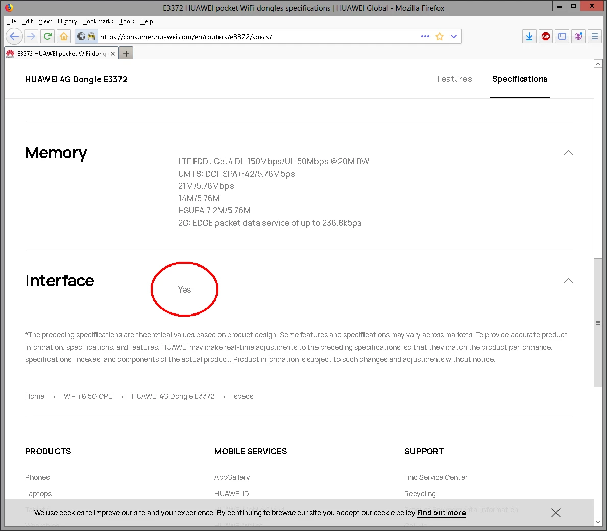

waclawek.jan
May 31, 2020 9:31 PM UTC
This is what the manufacturer had to say in this regard, verbatim:
