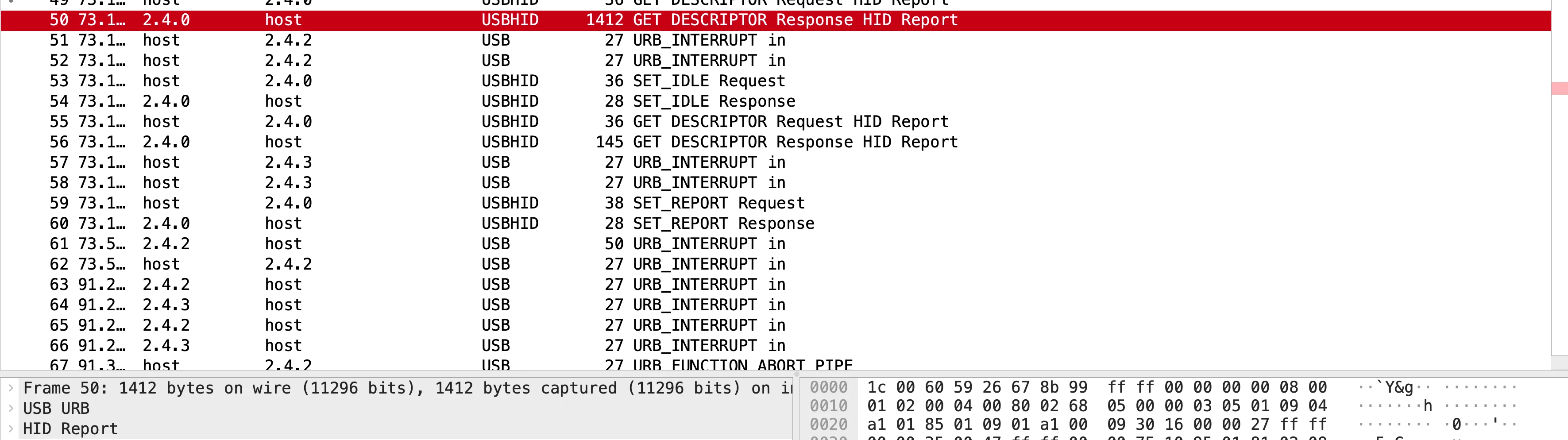

  • Descriptor Verification: Prior to writing the firmware, I audited the HID report descriptor (extract attached below) captured via Wireshark. I confirmed that both Report ID 0x05 and Report ID 0x06 are strictly classified as Feature Reports.
Capture HID Report

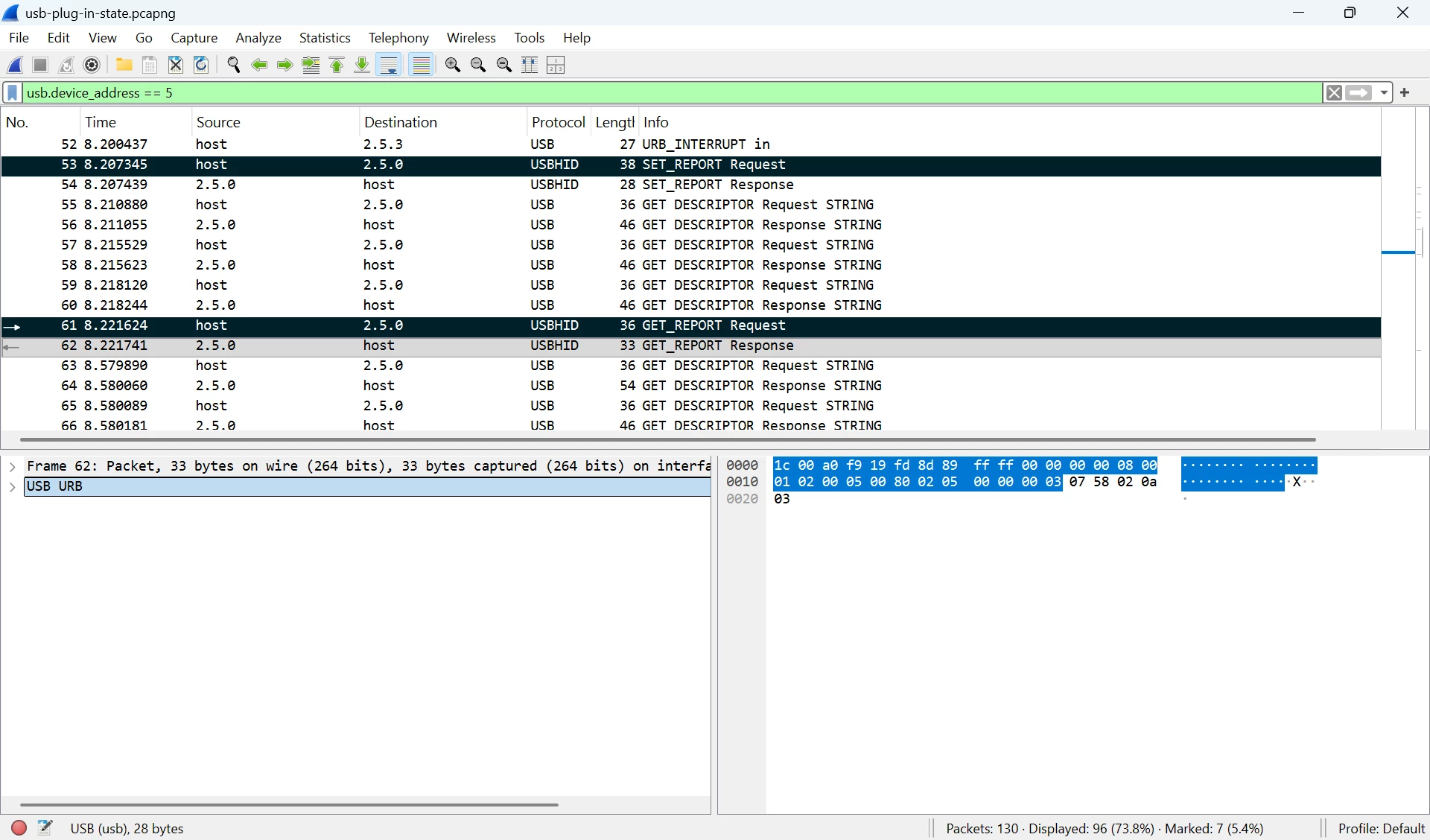

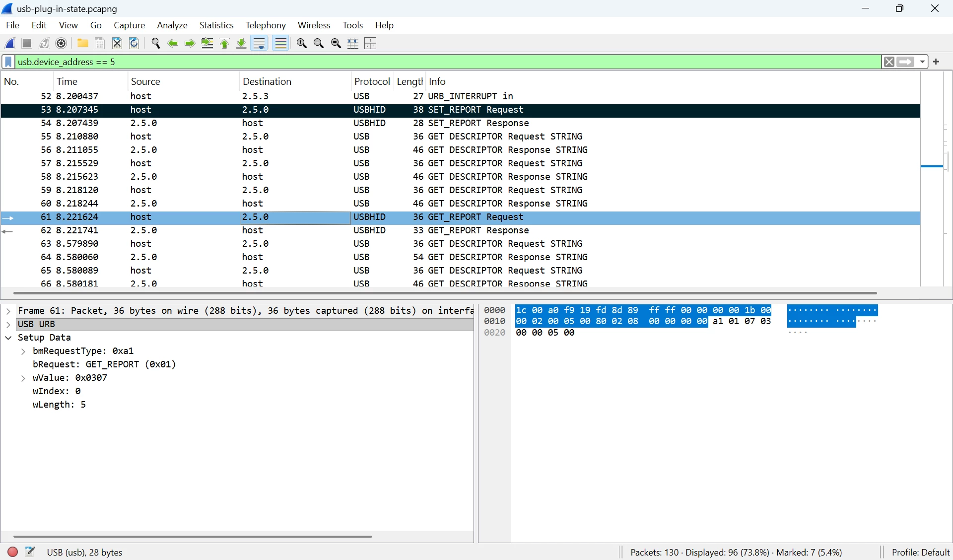

I have an update. I plugged in the PXN V9 Gen2 and it works with Euro Truck 2. I saw the data in Wireshark and tried to follow it.
static USBH_StatusTypeDef FFB_GetPool(USBH_HandleTypeDef *phost) {
PXN_HandleTypeDef *handle = (PXN_HandleTypeDef *)phost->pActiveClass->pData;
(void) USBH_memset(handle->ffb.get_buf, 0, sizeof(handle->ffb.get_buf));
return USBH_HID_GetReport(phost, 0x03U, 0x07U, handle->ffb.get_buf, 5U);

I don't know why I'm getting all zeros. It should show some data, just like it does in Wireshark.
GET_REPORT Request
GET_REPORT Response
You can see it has data like 07 58 02 0A 03. Even though my data shouldn't be exactly the same, I don't know why mine is all zeros. Did I do something wrong?

I assume no Interrupt IN notification is required for the PID Block Load flow. The PID spec defines Block Load as a Feature report returned via Get_Report on the Control pipe, not as an interrupt event. So the absence of async INT traffic is not itself a fault.
You need to separate device to host PID reports are expected to be delivered over the Interrupt IN path when the device exposes that endpoint and cannot be handled through control endpoint.
The Control “pipe” (called in host mode) Get_Report  is a separate host initiated retrieval path.
Your GetReport matches the request format. But can you print full 5 bytes response since wLength = 5?
for(int i=0;i<5;i++) {
printf("%02X ", handle->ffb.get_buf[i]);
The device is not refusing GetReport in general. The remaining issue is host side implementation, buffer handling, or both…
You must match the exact report ID, report length, interface number, required PID state sequence, and the STM32 host control transfer handling.
