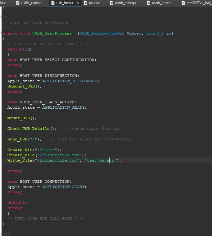

Hi, I am trying to make the MCU the host where a USB can be connected, and the MCU can read/write to the USB. I configured my IOC /CubeMX to use the USB with FATFS. The USB USE OS (RTOS) is automatically enabled.
However, the issue is that once the USB is plugged in, it reaches HOST_USER_CONNECTION then goes straight to HOST_USER_UNRECOVERED_ERROR and keeps looping on this. I've attached the file for file handling where my case statements are. I've tried configuring all the buffers from CubeMX whether it be USB data buffers, max size configuration, USBH process stack size, sector size, etc.
I've also attached the callback I'm using to handle the USB.

Please see How to insert source code for how to post source code - not as a screenshot.
@Priyank wrote:
goes straight to HOST_USER_UNRECOVERED_ERROR .
What error is it ?

Hi, I apologize for the incorrect method previously, I've added the code from the screenshot here according to guidelines. I'm not sure what the error is, but it comes from this list I've attached below in usbh_core.h. I've traced the error back to the original function call and its the USB just instantly erroring out after connection. I have a feeling it is something from the CubeMX configurations or clock speed, however I've tried editing it all, can't trace the issue back.
#define HOST_USER_SELECT_CONFIGURATION 0x01U
#define HOST_USER_CLASS_ACTIVE 0x02U
#define HOST_USER_CLASS_SELECTED 0x03U
#define HOST_USER_CONNECTION 0x04U
#define HOST_USER_DISCONNECTION 0x05U
#define HOST_USER_UNRECOVERED_ERROR 0x06U
static void USBH_UserProcess (USBH_HandleTypeDef *phost, uint8_t id)
 /* USER CODE BEGIN CALL_BACK_1 */
 switch(id)
 case HOST_USER_SELECT_CONFIGURATION:
 break;
 case HOST_USER_DISCONNECTION:
 Appli_state = APPLICATION_DISCONNECT;
 Unmount_USB();
 break;
 case HOST_USER_CLASS_ACTIVE:
 Appli_state = APPLICATION_READY;
 Mount_USB();
 Check_USB_Details(); // check space details
 Scan_USB("/"); // scan for files and directories
 Create_Dir("/folder");
 Create_File("/folder/file.txt");
 Write_File("/folder/file.txt", "test data\n");
 break;
 case HOST_USER_CONNECTION:
 Appli_state = APPLICATION_START;
 break;
 default:
 break;
 /* USER CODE END CALL_BACK_1 */
