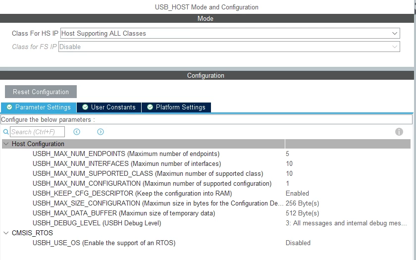

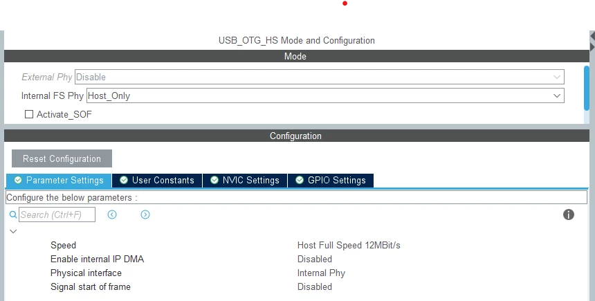

Ok, let's see the settings
0693W00000KdDN1QAN.png0693W00000KdDM3QAN.pngHonestly except for the buffer size (which is at the maximum 256 byte) i think that there aren't wrong settings here because it communicates.

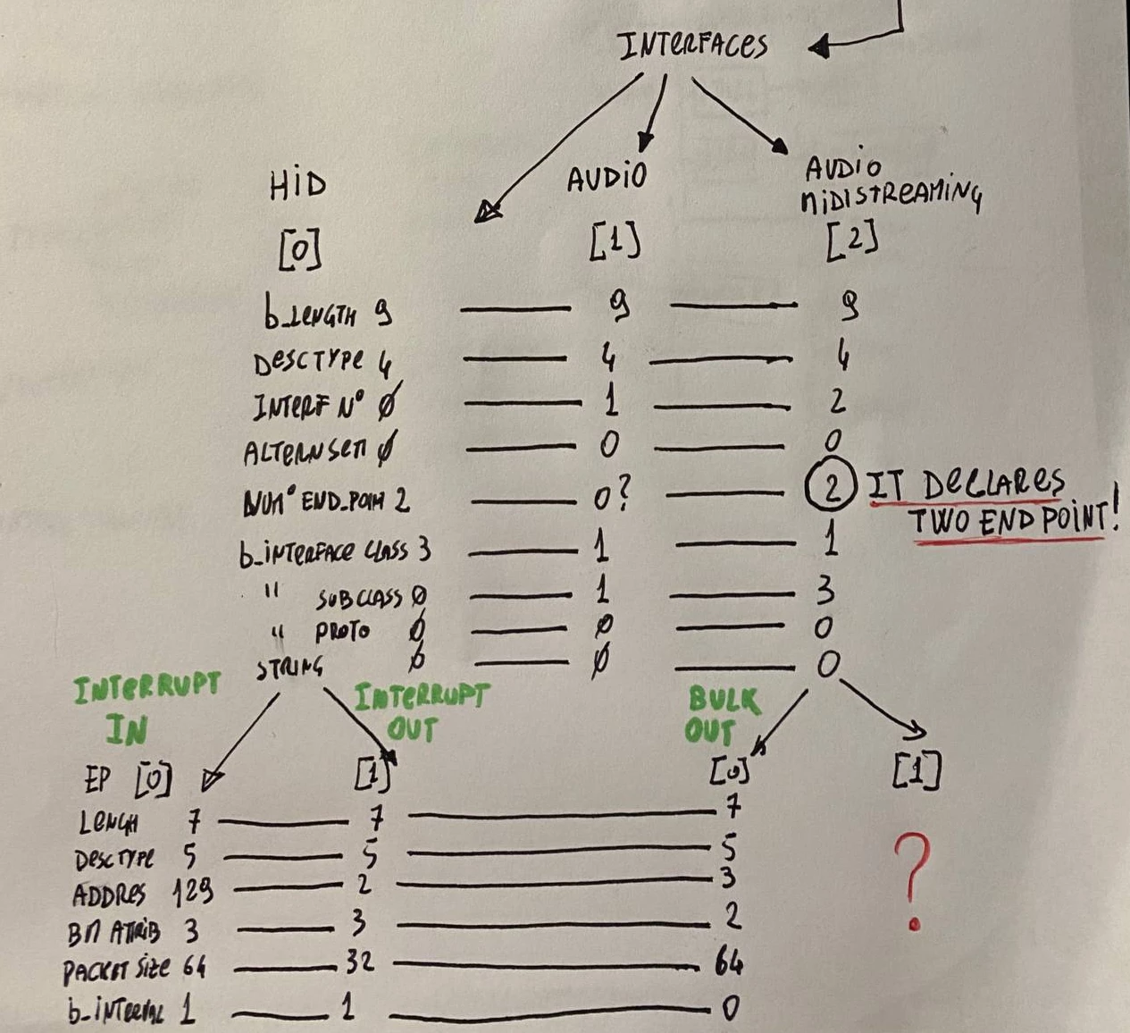

Below I have drew the structure and the values of the device descriptors from the three interfaces to the four end points. (The interface [1] has no end points. Is it normal?)
0693W00000KdDRXQA3.pngThe values that we are seeing there come from the hUsbHostHS HandletTipeDef and are the same that I see in the USB sniffer. Except for the last endpoint (marked with a red "?") the values coincide.
I drew the scheme because the online visualization of this structure is too long to be show in only one image.

> The MAX SIZE CONFIGURATION BUFFER is too small
Sounds likely. What is the total length of Configuration descriptor in question?

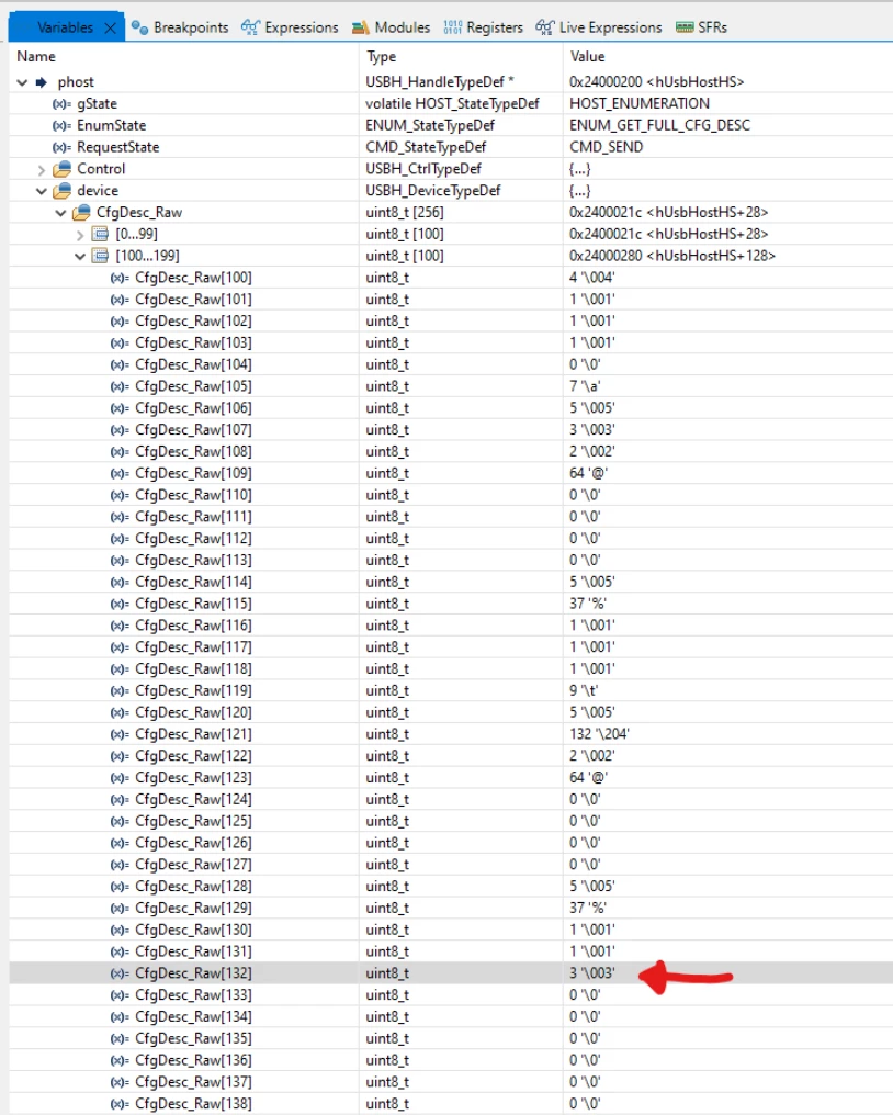

Below you can see the raw data descriptor. It seems to be long only 132 byte.
0693W00000KdK1MQAV.pngCan you tell me if I'm showing to you the correct raw data?

Bytes 2 and 3 form a 16-bit value, wTotalLength, determining the length of complete configuration descriptor "assembly", and it's indeed 133 bytes, so that's OK.
Descriptors you've marked "I don't know what it is" are class-specific descriptors - the first interface is HID, so look into the HID class documentation for that; the other interfaces are Audio class, again look into the Audio class documentation to find out what those are.
What may happen here is, that the Audio class redefines the Endpoint descriptor, extending it from the standard 7 to 9 bytes. In the code snippet you posted above this is reflected in
pdesc->bLength = 0x09U;
but the descriptor you've posted uses 9-byte EP desciptors also for subclass 3. Now how does this exactly lead to failure to parse I don't know, the key is in the functions called from that snippet and I don't use Cube and have no intention to debug it myself.
