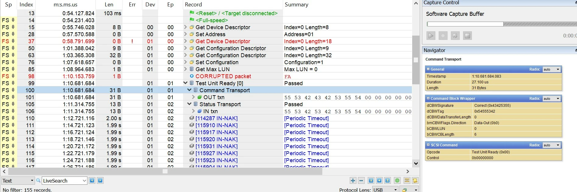

USB Host Bulk Input NAK || STM32U575
Hi All,
I am working on the STM32U575 for host mass storage class.
I am not using stm32 middle ware for this due to some reasons.
I am using TinyUSB open-source stack to implement the Host mass storage class.
with my current implementation I am able to use HID device, but I got stuck at MSC enumeration.
Currently facing below issue.
1. During enumeration process After sending the Unit Test Ready Command I am getting correct CSW
response from device but soon after that Getting NAK from USB device.
-- What could be the reasons for getting the NAK - Also I after getting NAK I am continuously getting Channel halted interrupt.
I have attached the logic analyzer file for batter understanding.
Any Help will be highly appreciated!

a NAK means the Firmware stack not able to respond in required timing to an IN packet, so most probably the state machine  of the stack seems in a wrong state before or when responding to the Unit Test ready command , therefore all next transactions are halted . I would suggest to try to comment that command in the stack for debugging purposes and see if the issue is happening in the command just before ? Another check to use another USB key or any other mass storage device to check if such commands are supported.  I’m not expert of USB just to give some pointers. Hope it helps you.

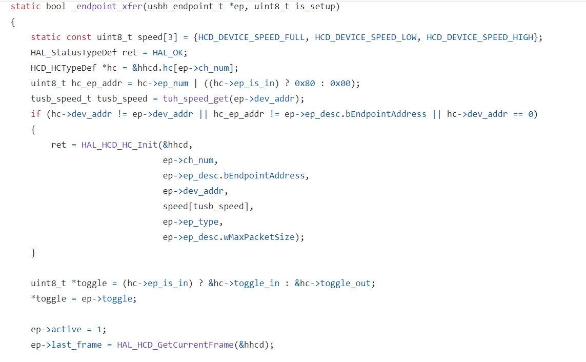

ACapo.1 not sure if the root cause will be same for you or not? as in my case I was using our own implementation for developing low level USB drivers, we were not using cube MX.
but any how, the root cause was related to the size of data bytes. as after unit test ready command, when we were trying to send next command which was having data bytes more then 256 bytes, USB device was giving NAK.
to overcome this issue, we were sending the data in chunk of 256 bytes.

Okay so you are also using the same tinyUSB stack, so Mostly you might have used the same driver file which I used.
STM32F7xx Host driver (github.com)
I was also able to use the MIDI initially and then facing the issue with bulk driver only.
for tinyUSB driver file you should handle data in chunk for length more then 256 byte.
Also
under HAL_HCD_HC_NotifyURBChange_Callback function()
currently endpoint toggle is unconditional,
   ep->toggle = (hc->ep_is_in) ? hc->toggle_in ^ 1 : hc->toggle_out;
change it to.
    if (hc->ep_type == EP_TYPE_INTR)

Sorry my bad, you have to change in _endpoint_xfer() function only,
if (ep->ep_type != 2)
    uint8_t *toggle = (hc->ep_is_in) ? &hc->toggle_in : &hc->toggle_out;
    *toggle = ep->toggle;
I kept one more check in HAL_HCD_HC_NotifyURBChange_Callback(), but it was for some other purpose.
regarding handling of data more then 256 bytes(rather size more then wMaxPacketSize), you will face that problem may be after making this change. because that is not handled currently in that driver file.

That _endpoint_xfer() change brings it all to life, thanks very much.
If I have the USB inited as HS then both FS and HS devices work fine, I do not get the issue with the transfers being bigger than the packet size.
With it inited as FS then I see the issue that you mention with HS devices, but strangely FS devices work even though the transfers are bigger than the packet size.
