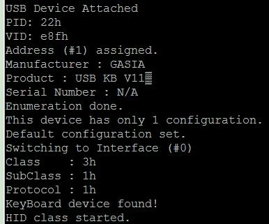

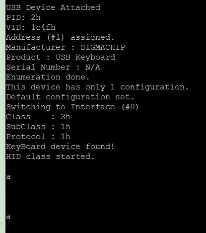

Hi, I have the same problem!
Some keyboard are OK, but some keyboard can be detected but can't get the data.
I use STM32L496-NUCLEO board with STM32CUBEMX USB HID project.
Someone help me!
this GASIA keyboard can't read data:
this SIGMACHIP keyboard can read data:
