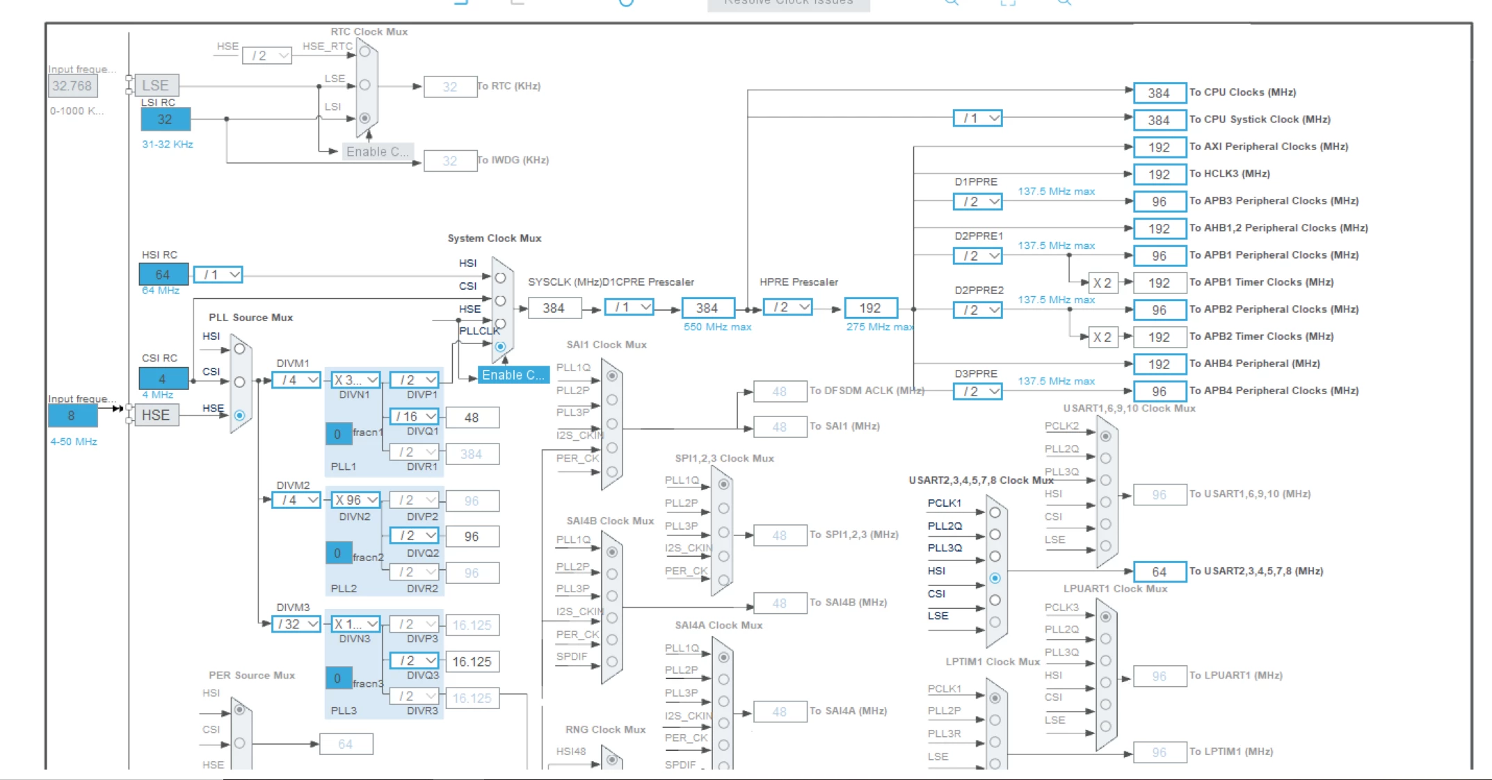

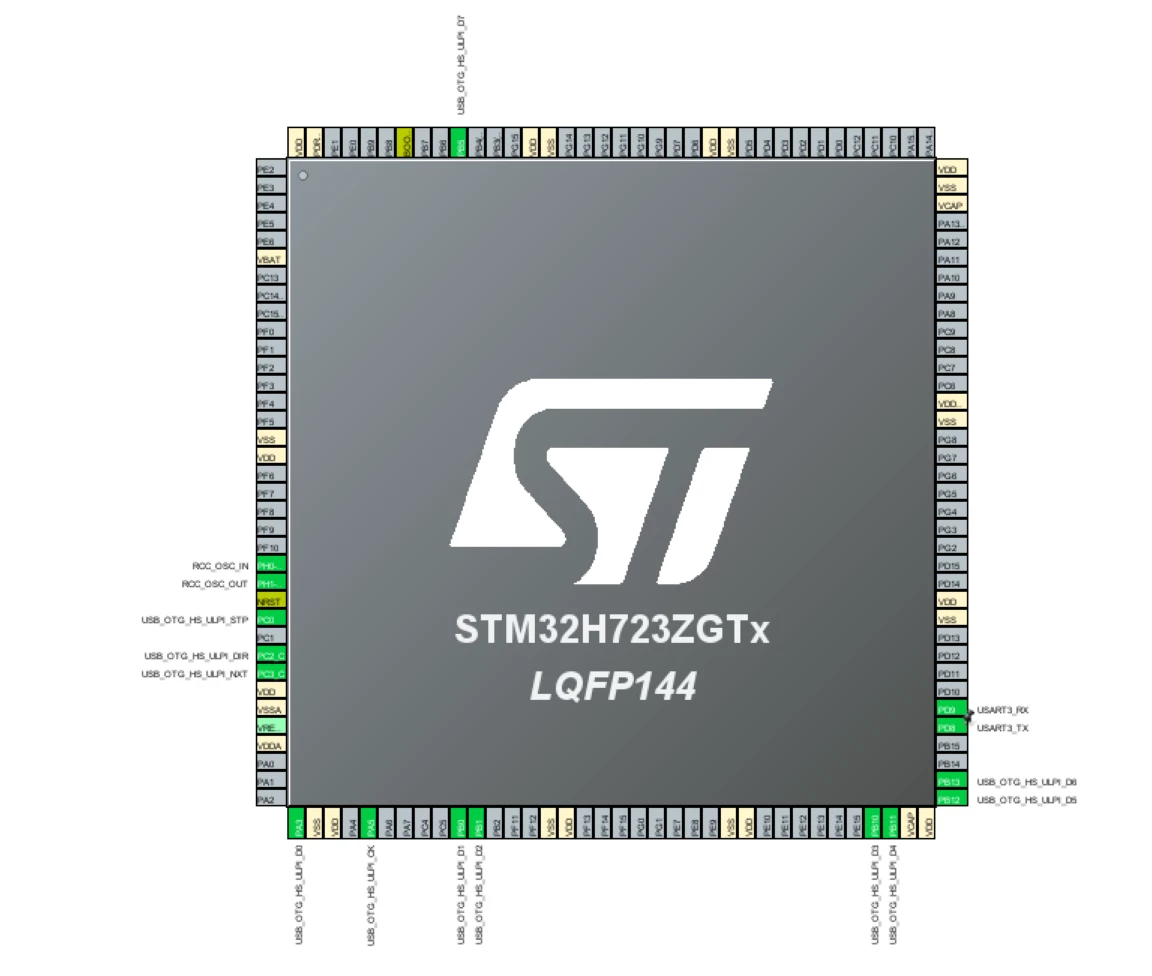

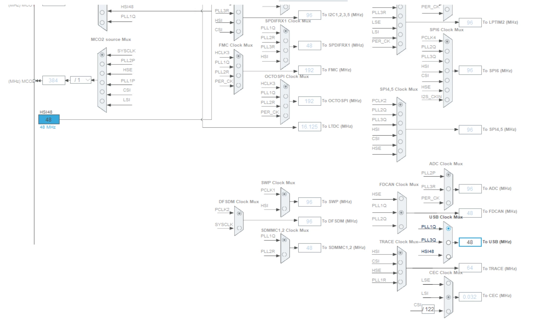

Feb 25, 2024 1:01 PM UTC
Thanks for the quick reaction.
Is the ioc file good enough?
Here are some pictures of the clock.
I'm working with a Nucleo Board H723ZG and for HSE, use the 8MHz from the STLK_MCO.
My constraint with the clock is that I am planning to the FDCAN module with 96MHz from PLL2Q.

Feb 25, 2024 2:51 PM UTC
Hi @RichFarmer ,
if you are using our Nucleo, I assume using some flying wires to hook the signals to the USB3300 or my understanding is wrong .  I would suggest to run the default examples of High Speed USB keeping the same Clocks configuration before changing them to your requirements.  Also to check how the 60MHz going to the PHY is generated?

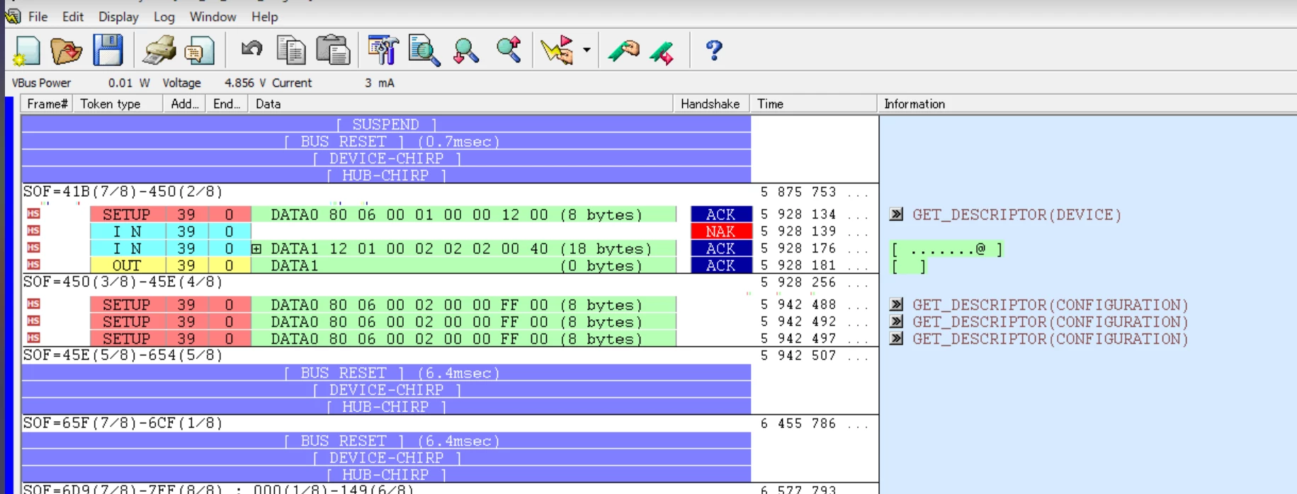

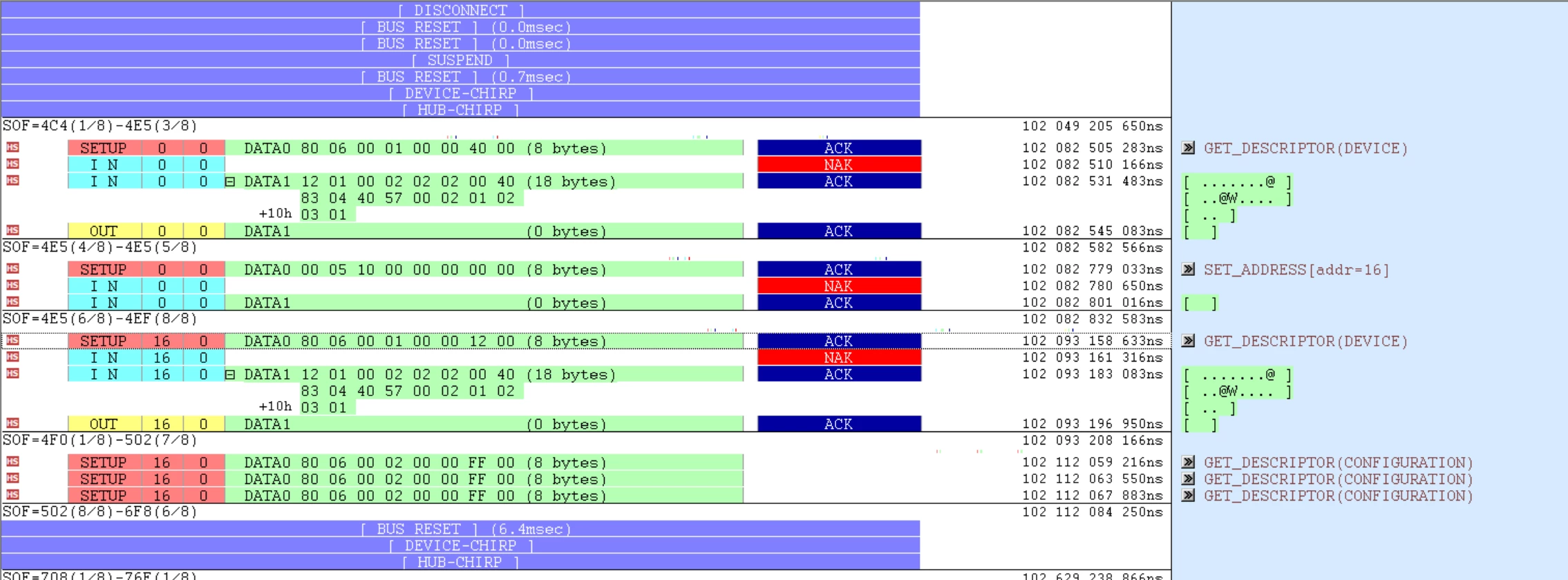

Feb 26, 2024 1:50 AM UTC
@STOne-32
Yes, I am using some flying wires and am aware that there is a huge chance that my problem is the signal impedance or layout. But, isn't anything else I could check before just changing the board and layout?
Even with the default example and clock configuration (just change the USB_OTG_HS module to use external HS phy), I am facing the same problem.
The setup starts. Chirp is recognised as HS. The device sends its descriptor and receives an address from the host. The device then resends its descriptor using now the address attributed by the host. The device tries to send its configuration but doesn't get any ack or nack and the setup fails here.
So far, the data that I can read in the descriptor (PID, VID, etc..)with the protocol analyser looks like my settings. So, since the data is "partially" correctly recognised, I would like to go through the setup...
If anyone could direct me to the function or part of the program handling the communication or setup of the device, it would be helpful.
Thanks

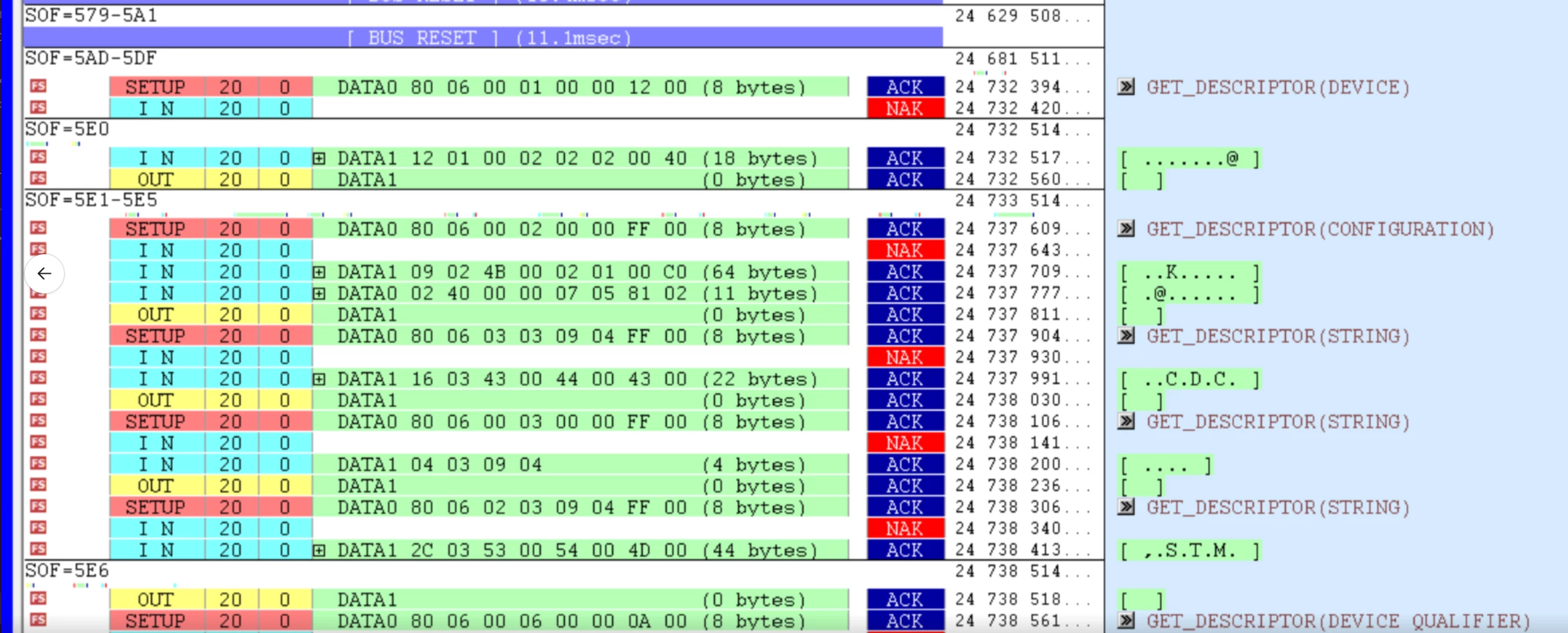

PS:If it may help: a picture of the protocol analyser result and the data in the descriptor(device)
Feb 26, 2024 7:49 AM UTC
The HSE signal is from the HSI of the st-link chip and will not be sufficiently accurate for USB purposes. You need a clock source from a crystal.
Probably not going to get it to work with jumper wires, regardless.

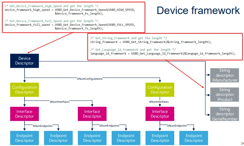

Apr 3, 2024 12:41 PM UTC
Hello @RichFarmer
Sorry for not reaching out sooner. About your last question, at device descriptor level, you can get device framework for high speed within you can get the length and  string_framework
