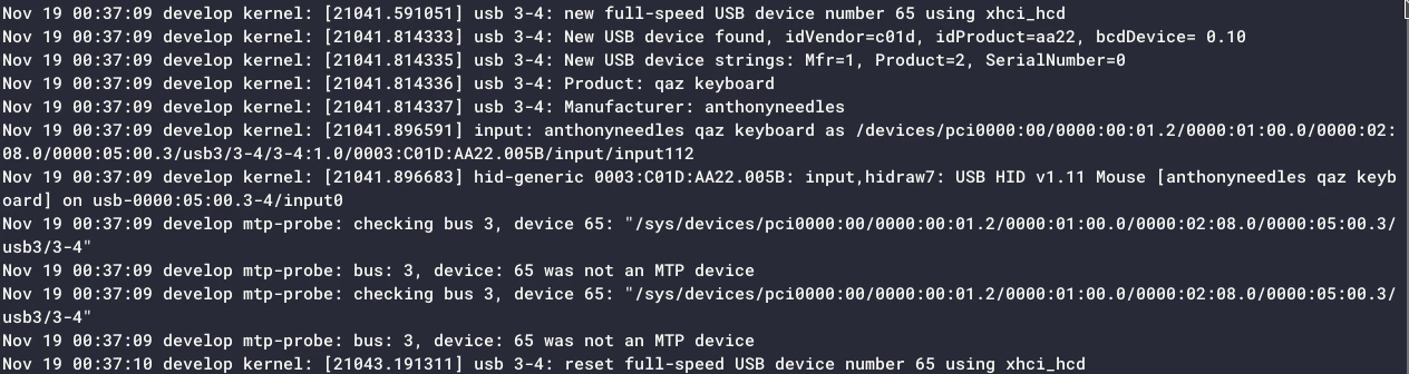

I'm doing the testing on a Debian machine. This is the output of `tail -f /var/log/syslog`:
As you can see, the host gets the string descriptors, and identifies the device as an HID Mouse device. But I resets right at the end (I'm almost positive the mtp-probe stuff has no effect).

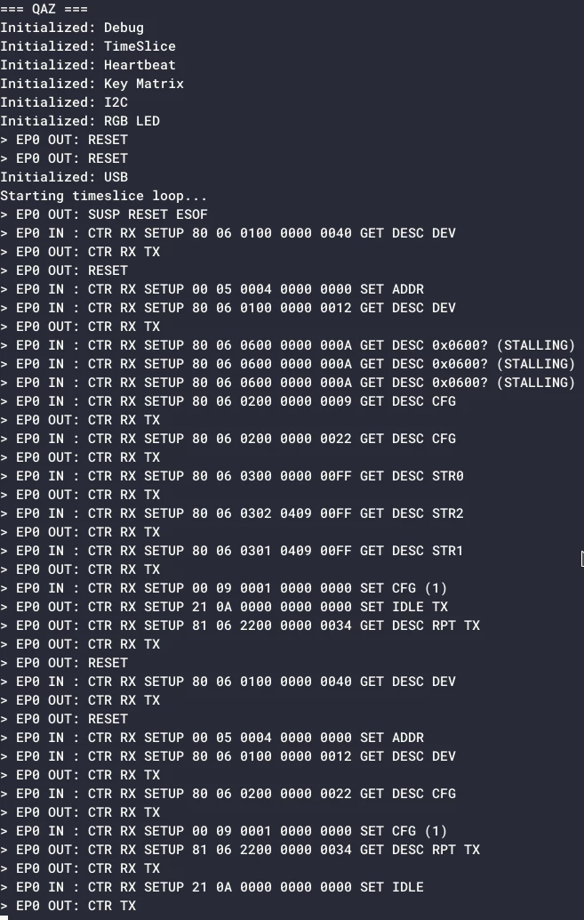

Here is the output from the serial debug output:
0693W000005C0baQAC.pngThe format of the printouts is:
  • `>` - the start of a USB interrupt
  • `EPn` - the EP that the interrupt is related to
  • `IN`/`OUT` - direction of successful EP transaction (`OUT` can also mean both TX/RX)
  • The next bit shows the reason for the interrupt, usually `CTR` (correct transfer) or `RESET`
  • In the case of a `CTR`, `RX` indicates the EP had a correct `OUT`/`SETUP`transaction, and `TX` an`IN` transaction.
  • Then `SETUP` if the transaction was a `SETUP`. The string of numbers is the contents of the `SETUP` request. Then, the description of the request (Get Descriptor, Set Address, etc.), followed by the descriptor in the case of Get Descriptor.
We can see the device proceed through enumeration, get to the Get Descriptor, Report request then immediately `RESET`.

The last log record was CTR TX. Was it a control request?
-- pa
