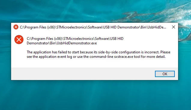

USB HID Demonstrator running issue on windows10
I am working on nucleo-h745ziq board.Interface the usb as custome HId. I try to install the USB HID Demonstrator but it throws error .There is another terminal so I can use ? Please help me

Jul 6, 2021 7:32 AM UTC
Hello @MDeva.1​ ,
Can you please precise the error message you have (if possible share screenshot) ?
Imen
MDeva.1
MDeva.1Author
Jul 6, 2021 7:41 AM UTC
First time i am using the windows 7 it operates on that but when i tried to install on the windows 10 it shows this error to me.0693W00000Bcu1UQAR.png
YLive.1
YLive.1Best answer
Visitor II
Aug 31, 2022 2:31 PM UTC
Hello, i have this error too. So i download " Microsoft Visual C++ 2005 Service Pack 1 Redistributable Package MFC Security Update" from microsoft and Install (vcredist_x86.exe) (vcredist_x64.exe).Now everything worked!
USuha.1
Visitor II
Nov 8, 2022 10:48 AM UTC
The Solution suggested by YLive.1 is working fine for me on Windows 10.
