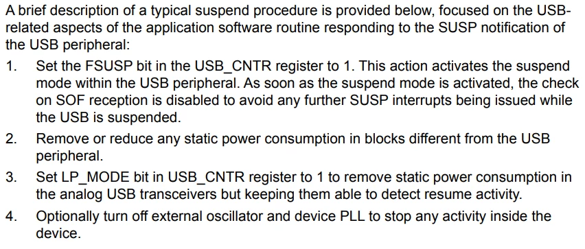

Hi again @MCG
The code you mentioned is specific to F446 which does not implement the same IP USB. Here is the procedure to follow to enter suspend mode using L0x3.
Note that when in low power mode, debug cannot be used (IAR and Keil doesn't support it)
To give better visibility on the answered topics, please click on "Best answer" on the reply which solved your issue or answered your question.Best regards,FBL
MCGAuthor
April 23, 2024
Hi @FBL, the issue isn't trying to go into suspend mode. It was that I couldn't get it out of suspend mode unless it is interrogated by the host. My button would not send the string when pressing it once it had been suspended.
Is this a problem, or is this just how USB works as this is my first time doing a USB project. It now works fine since changing the code to sending a string when being asked by the host.
