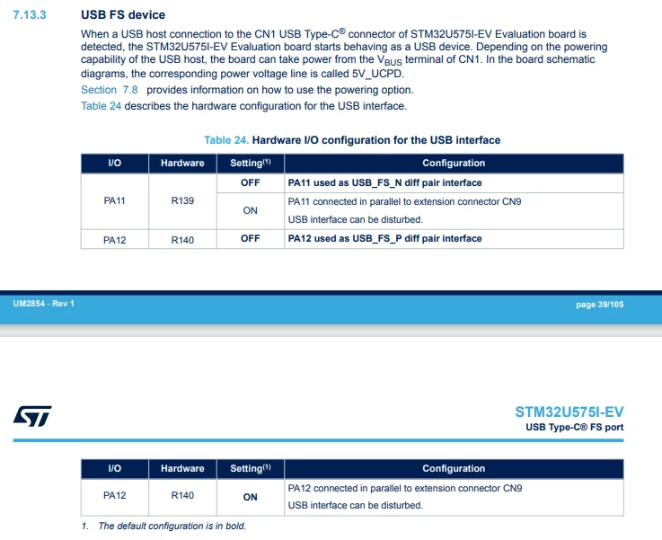

Hello @RRajb.2 ,
You can review the settings in the STM32U575I-EV User manual and check Table 24. Hardware I/O configuration for the USB interface.
Imen

I have gone through the user manual you mentioned above for, configuring the STM32575i-EV evolution  board in host mode.
But I don't see any specific jumper settings for usb host mode, only USB device settings are mentioned.

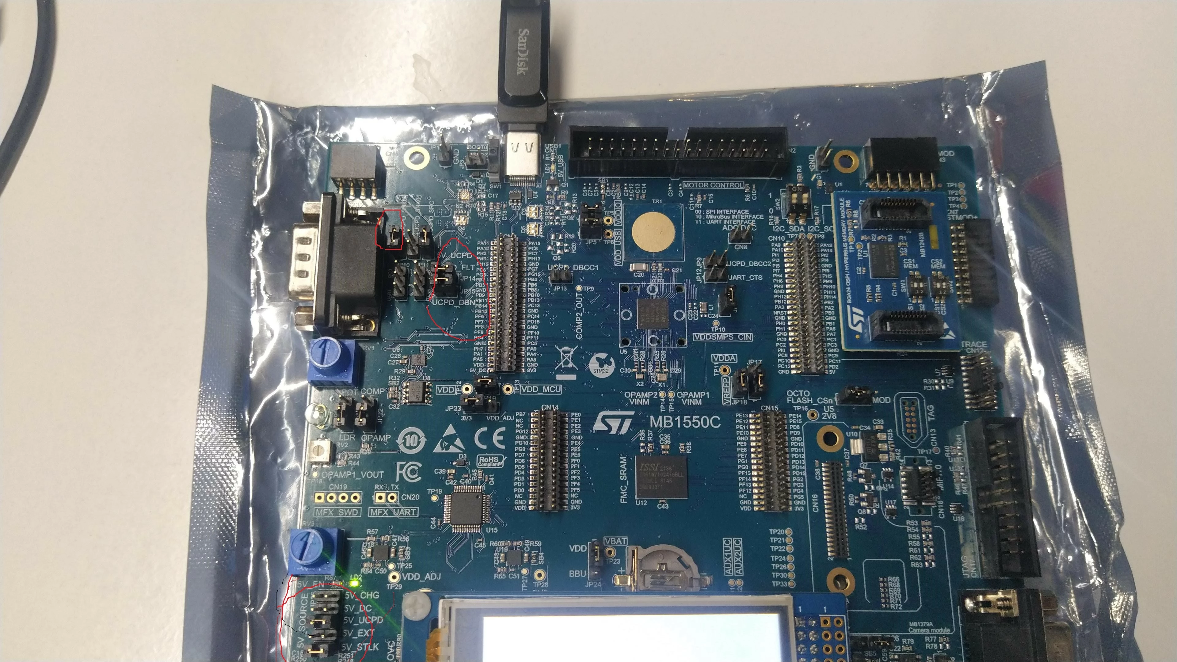

As per the below readme file.
/STM32Cube/Example/Ux_Host_MSC/readme.html
I have configured or connected below jumpers.

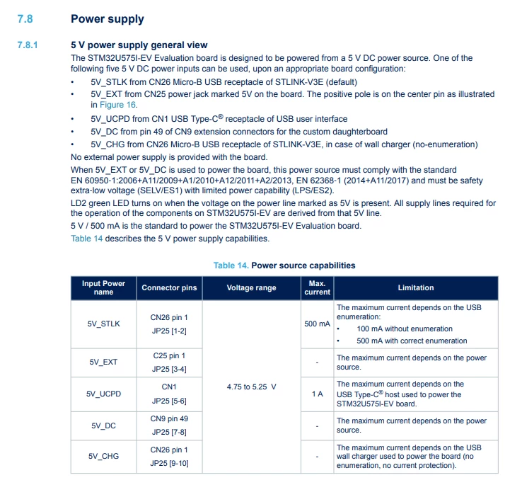

JP25 : UCPD_5V Jumper
JP6 (UCPD_SRC) : Please on this jumper UCPD_SNK02 is mentioned on board.
JP14 and JP15 : both are connected to 1-2.
I am trying to run the example code for Ux_Host_MSC, But Not able to see anything on console or not able to see any interrupts occurring.
Could you please let me know all relevant jumper settings for host mode?
I have attached the board image and have marked the jumpers, which I have connected.
