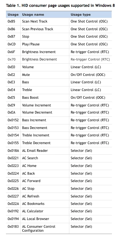

Does anyone USB Device HID Keyboard example? I'm struggling to modify USB mouse example into keyboard. Read some literature, tried to modify descriptors, but no luck...

> Now I'm struggling to make multimedia keys work. 'Multimedia' keys belong to HID consumer device, apart from other keys (HID keyboard). - To send these keys, you have to modify your report descriptor completely for HID consumer device. - If you would like to have 'multimedia' keys with ordinary keys, you should make a composite device, HID keyboard + HID consumer, because Windows don't like merged keyboard with other HID device(s) using TLCs (Top-Level Collections). In this reason, all of PC keyboards are composite devices. The support of 'multimedia' keys depend on OS. Windows support is described on keyboard-support-windows-8.docx, downloaded from this MS page,
https://msdn.microsoft.com/en-us/library/windows/hardware/Dn613956%28v=vs.85%aspx
0690X00000604vjQAA.png The keys are assigned to bits on the input report one by one. For example,

Ah I remember,
Volume up/down usages are RTC (Re-Trigger Control) type.
To up/down volume stepwise, your device should send two contiguous reports,
the first report holds 1 at volume up/down bit field
- user presses volume up or down key
the second report keeps 0
- user releases above key
If your device would send just the first 1 report without the second 0, the OS could interpret this behavior as ''volume up key is continuously pressed.'' And then, it should maximize the volume.
Please take care, so that it wouldn't break your PC speaker (or your ears ;)

Thank you so much!
It worked :)
