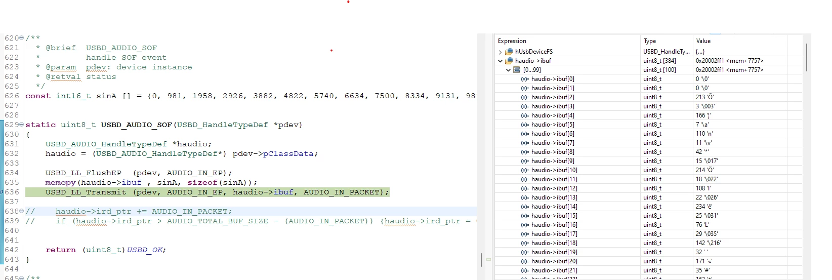

So far all I know is the USBD_AUDIO_DataIn is not getting called and from what I have read so far this is the function where I am supposed to be handling the sending data to host.
I have been trying to get this working for weeks and I have had it working in the past with the following conditions: I put the LL_Transmit function in the USBD_AUDIO_SOF function. This worked as the audio data is supposed to get polled every 1ms anyway. Then I had the problem that every other packet sent was empty, so I added the LL_Transmit function back into DataIn stage and now my sine wave was being sent perfectly. Which is really weird if you think about it. I cannot imagine that the library was designed to be used this way.
The weird thing is, if I do not use the SOF cb the DataIn stage is also not called.

Here is a picture of some code where I am trying to send just a single array over and over again.

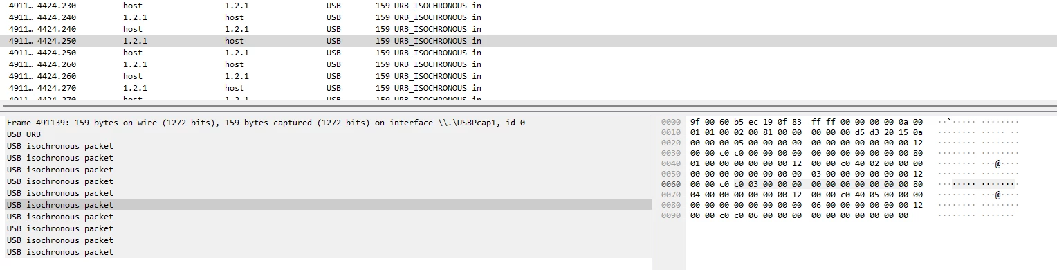

Here follows a picture of wireshank showing empty packets:
_legacyfs_online_stmicro_images_0693W00000bhfkxQAA.pngAs you can see
all packets are empty.
why?

I found the solution.
1) You do not need SOF interrupts, disable them.
2) STM32 HAL works perfectly fine. The problem emerges because the HOST reacts to USBD_LL_Transmit() only after several SOF frames. This means that USBD_LL_Transmit() in this code is useless:
USBD_LL_OpenEP(pdev, AUDIO_IN_EP, USBD_EP_TYPE_ISOC, USB_BUF_SIZE);
pdev->ep_in[AUDIO_IN_EP & 0xFU].is_used = 1U;
USBD_LL_FlushEP(pdev, AUDIO_IN_EP);
USBD_LL_Transmit(pdev, AUDIO_IN_EP, (uint8_t*)&someData, SEND_SAMPLES * 2);
3) All we need is to wait for some time (5 SOF frames on my Windows 11 system) after USBD_LL_OpenEP() and only then call USBD_LL_Transmit()
Bad way: call USBD_LL_Transmit() from SOF interrupt. As soon as you've got first USBD_AUDIO_DataIn() callback, only call USBD_LL_Transmit() from USBD_AUDIO_DataIn().
The good way: disable SOF interrupts. Monitor when HOST selected alternate mode, do a first USBD_LL_Transmit() with some delay from the main loop. All the consequent transfers will be automatically handled by USBD_AUDIO_DataIn(), from which you transfer microphone signal using USBD_LL_Transmit().
I will use the latter method in my mic for youtubers project. Both methods work and tested on STM32H7B0 under Windows 11, but I need to confirm yet if it is the same for Android/Linux and MacOS.
