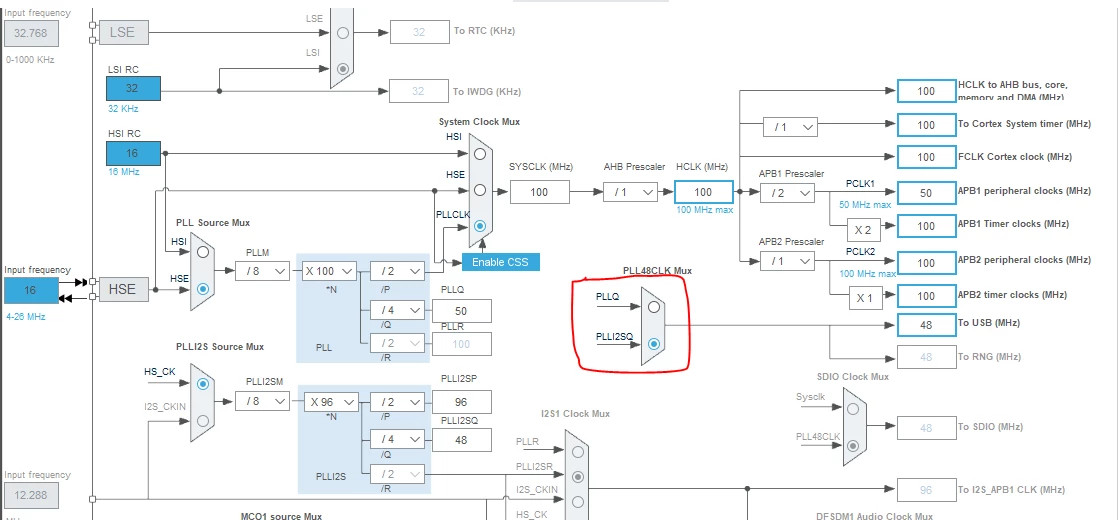

USB Clock Not surport PLLI2SQ? (STM32F412RE)
hello!

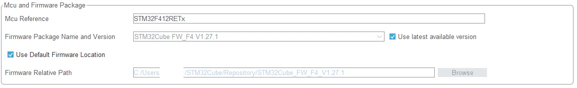

Your project is successfully worked for me (using STM32CubeMX 6.7 and STM32Cube_FW_F4_V1.27.1)

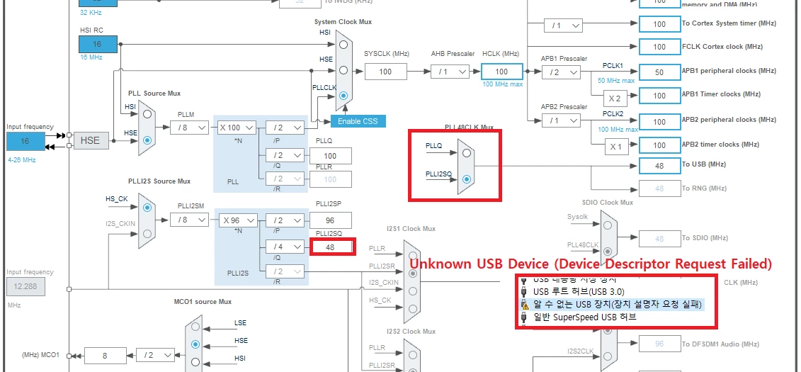

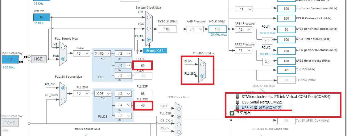

Select PLLI2SQ clock.
Unknown USB Device (Device Descriptor Request Failed)
0693W00000Y9Z6SQAV.png​

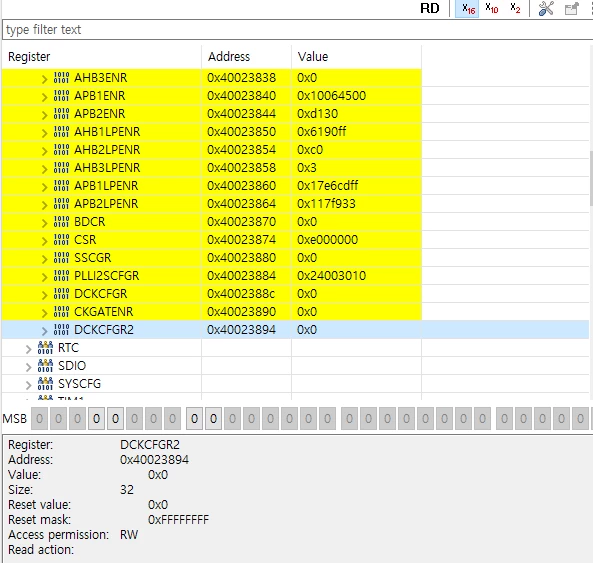

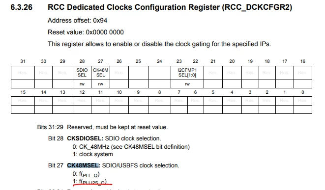

Not Setting PLL48CLK Mux ?​ PLLQ 50Mhz?

Which CubeMx version are you using?
Please share your ioc file in order to reproduce the case.

Most likely CubeMX just didn't configure that setting properly or at all. That is an absolutely normal thing for that broken bloatware generator.
