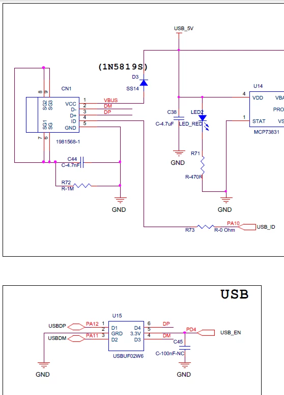

Designing STMF405 Board. Bit confused about USB functionality.
We need multi role USB functionality (from one usb connector).
The current usb circuit is as shown below.
The board should communicate with computer usb (Virtual com port) for data transfer.
Also, when the board connected to computer, it should appear simply as a usb mass storage device (like usb flash drive).
Do I need USB OTG ? As far as I know, it supports multi-role for usb.
No. Multi-role means that it can be host or device - not simultaneously, but at different times. For example, some digital cameras, they have only one USB connector;  when connected to printer, they act as a host and control the printer; when connected to PC, they act as a device (e.g. mass storage).
The expression you are looking for is ''composite device'', see e.g. https://en.wikipedia.org/wiki/USB#System_design second paragraph. It's only a device, you don't need OTG nor dual-role.
The STM32F4xx High-Speed OTG USB device is PHY-less (more precisely, its PHY is Full-Speed only), so if you want to use it as High-Speed, you need an extra chip, the High-Speed PHY. That's what is on the EVAL board; but the chip used there is hopelessly obsolete so.
