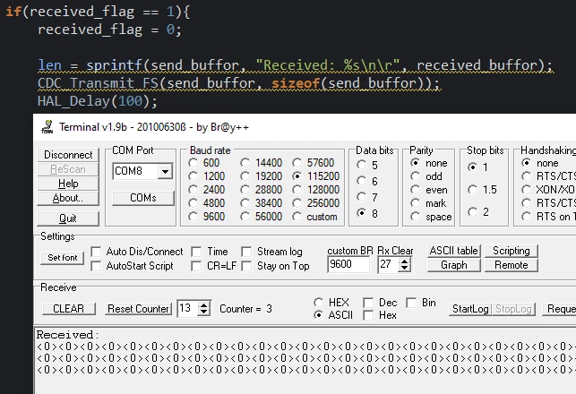

Hi, thanks for your answer! Whats sad about it, is that it doesn't work for me :\ Tried different delays (from 10, to 1000 ms). On terminal it looks like maybe its working, but i can't see received data.

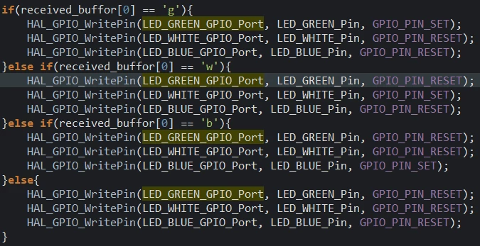

Also, received_buffor doesn't contain the data I've sent, because these conditions don't work (they worked before):
