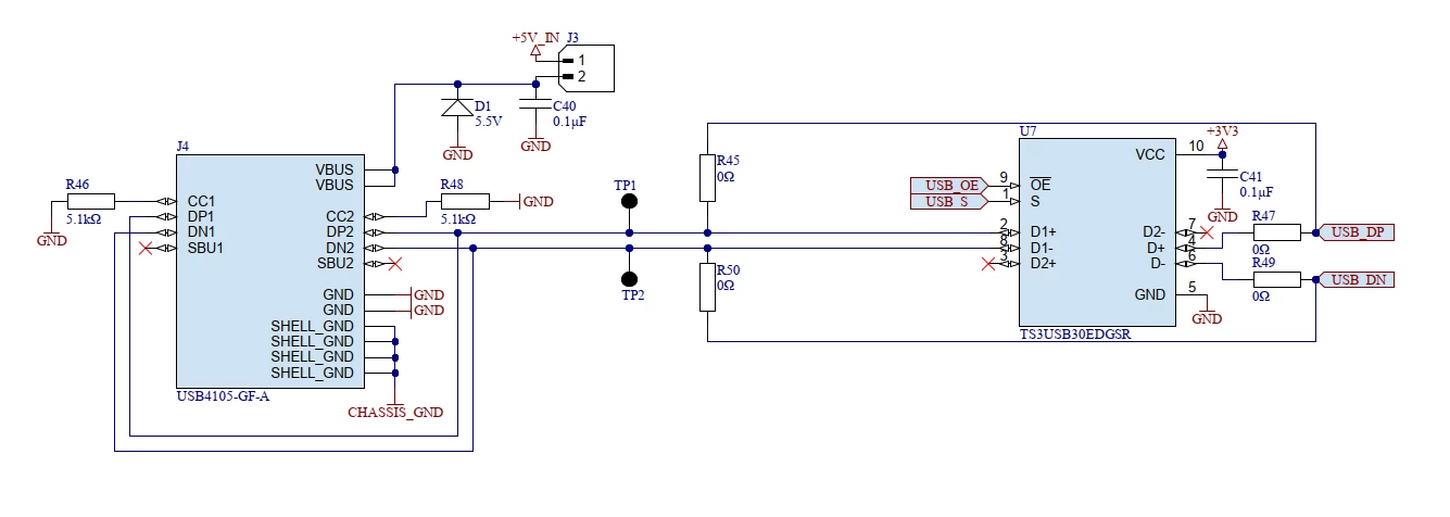

Hello everyone,
I am currently working on a project using an STM32H755ZIT6 MCU and want to use the USB CDC class to send data over USB. I can successfully program the MCU and the system clock configuration is correct. However, when I plug in the USB, the device is not recognized by Windows. I receive the following error message:
  • "Unknown USB Device (Device Descriptor Request Failed)"
  • "The last USB device you connected to this computer malfunctioned, and Windows does not recognize it."
Schematic details:
I have attached the schematic of the USB circuit to this post.
  • USB_DP is connected to PA12.
  • USB_DN is connected to PA11.
  • The circuit is powered via USB as well.
  • Currently, only R45 and R50 are mounted (0 Ohm), R47 and R49 are not mounted.
  • The TS3USB30EDGSR chip is not activated at this stage. I have the option to activate it if needed.
To make sure the MCU has enough time after power-up, I added a 3-second delay before initializing the USB stack.
Still, the USB device is not recognized.
If anyone has an idea what could be wrong, or if you want to see more files (like code, initialization settings, etc.), feel free to let me know.
Thank you for your help!

MOBEJ
Jun 9, 2025 10:55 AM UTC
Hello @_oepfel  ,
Please try using the provided a CDC example on the STM32H747I-EVAL board. You can port it to your specific board.
NB : Follow the instructions in the README file, which includes all the necessary steps to ensure your project works correctly.
In fact  This is a typical application on how to use the STM32H747xx USB OTG Device peripheral where the STM32 MCU behaves as a USB-to-RS232 bridge following the Virtual COM Port (VCP) implementation. -
- On one side, the STM32 exchanges data with a PC host through USB interface in Device mode.
- On the other side, the STM32 exchanges data with other devices (same host, other host, other devices…) through the UART interface (RS232).
Regarding your issue where the USB device is not recognized, this could potentially be a hardware-related problem. Please try the following troubleshooting steps:
Try plugging the device into a different USB port,  & Replace the USB cable: Sometimes the USB cable may be damaged, replace the cable with a new one to see if that solves the problem.
Br
Jun 9, 2025 11:20 AM UTC
Hi @_oepfel
In addition to the points mentioned by @MOBEJ .
  • Verify that the USB_DP and USB_D are routed as a differential pair with 90 Ω ± 10% impedance.
  • Minimize stubs and ensure the ESD protection device does not introduce significant impedance discontinuities
You can refer to this schematics as starting point.
To give better visibility on the answered topics, please click on "Best answer" on the reply which solved your issue or answered your question.Best regards,FBL
