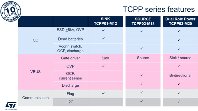

Back to this post, I wanted to know if having USB-Interface IC (such as TCPP03-M20) is mandatory for USB-PD communication between STM32L552 and USB-C adapter? I am a bit lost knowing which one of your chips is required. Could you please recommend one or more of these interface ICs that is in stock and production?
Thanks,
Amir
MROUV.1
Jul 27, 2022 7:22 AM UTC
Dear Amir,
TCPP IC are required to protect system (ESD, OVP, OCP, OTP on CC and Vbus lines). They also embed specific features related to Type-C connector (HV interface, Vconn switch, …).
The table below shows features by product.
You can notice that each TCPP corresponds to a use-case :
  • SINK : when system with STM32L552 requires power from Type-C cable
  • SOURCE: when system with STM32L552 can supply power to Type-C cable
  • DRP : when system with STM32L552 can do both (with a battery as example).
However, TCPP03-M20 can be use for SINK as it embeds Dead batteries resistors and Vbus current specific features that are not present on TCPP01-M12 (OCP and current sense).
