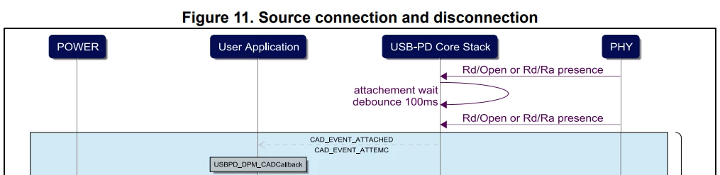

When acting as a source, G4 must present an Rp resistor then it must detect Rd resistor and wait for debounce!
CC1 should be connected to Rp first when acting as a SRC.

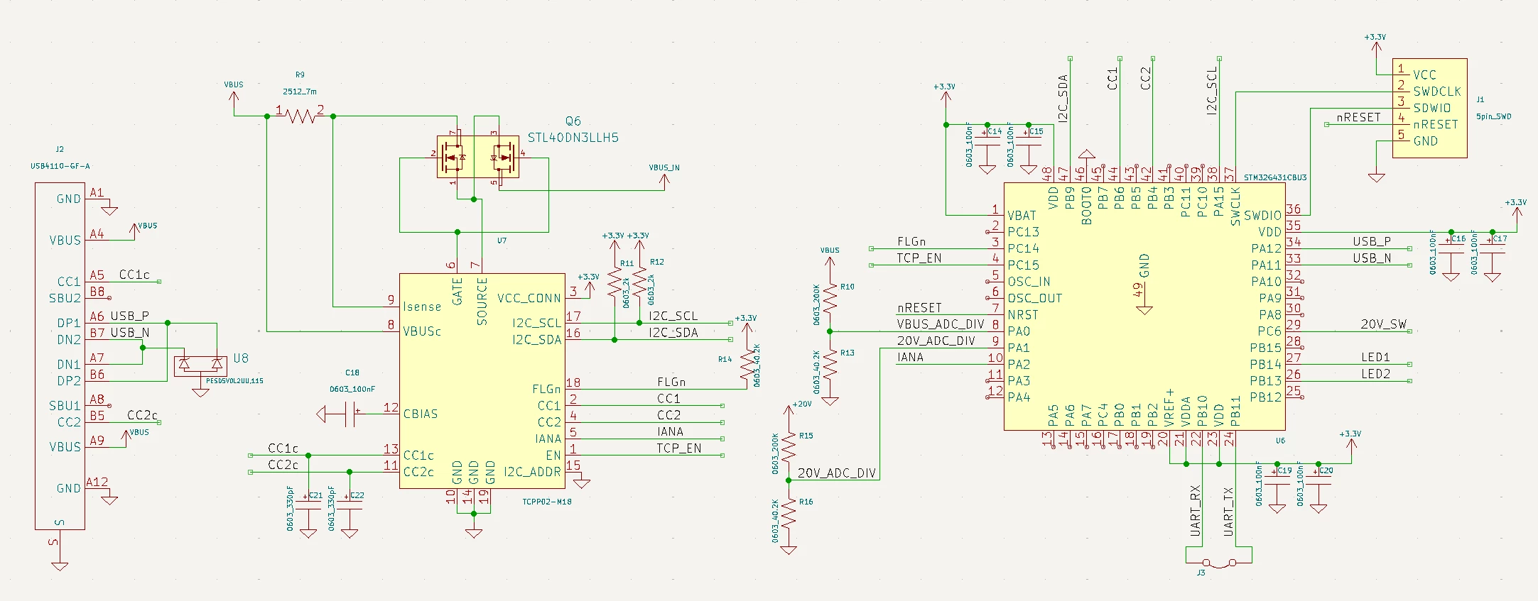

Pictured below is the relevant parts of my schematic, I based it heavily off then X-NUCLEO-SRC1M1 board that I have been developing with. I am not sure what parts of my project might be useful, so an entire archive of the STM32Cube IDE project is attached.
I noticed something very interesting though. I manually check the TYPECEVT1 and TYPECEVT2 interrupt flags in the UCPD_SR register in my code before the RTOS starts, and they seem to be working setting as intended when I plug in and unplug a USB cable. I can even clear them and retrigger them by plugging in the cable again.
BUT, they never seem to actually trigger an interrupt. It looks like they are supposed to trigger the PORTx_IRQHandler function located in the usbpd_hw_if_it.c file, but that never seems to happen either before or after the RTOS starts.
In fact, after the MX_USBPD_Init() function executes in the main function, I can't seem to get ANY interrupts to trigger. I tried triggering a basic gpio interrupt to trigger, but even that doesn't happen. I tried re-enabling interrupts with  __enable_irq() but that isn't doing anything.
Any ideas why interrupts are not triggering after the MX_USBPD_Init() function call?

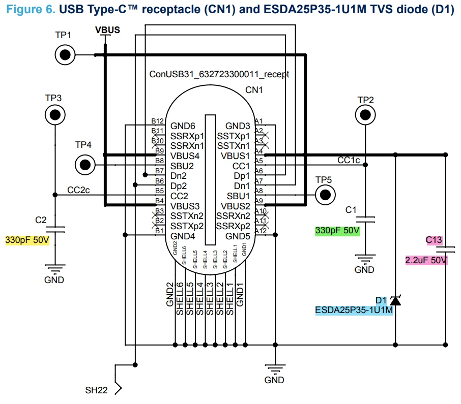

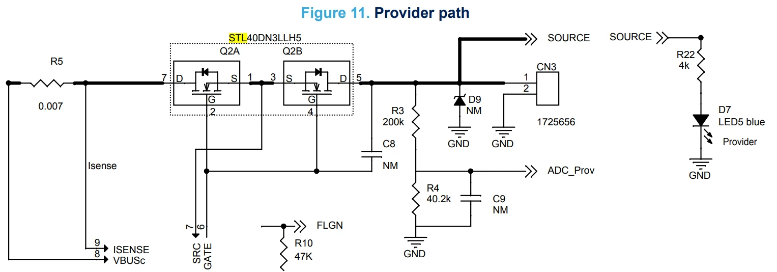

I figured out something that could be interesting in your board. R9 protects the TCPP02-M18
from overcurrent on the VBUS. When this voltage is higher than 0.042 V, the overcurrent protection turns on and
opens the provider path. So having 2512.7mOhm as OCP is too much. The recommended value is 7mOhm.
TVS ESDA25P35-1U1M D1 and C13 are missing as well
