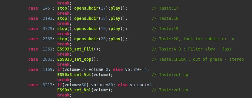

AScha.3
Nov 13, 2022 11:10 PM UTC
hmm, i almost agree.
but still you didnt show me some lines of your code... :)
for me, i need comments, like here, in IR-remote decoder:
0693W00000WICcMQAX.pngits just helping me, to understand what it should do - if i see it some years later.
and i think, its same for other people, that see it now.
good comments replace a separate "user manual" - then comments are, what i expect.

If you removed all the magic numbers. (assign them to constants)
Stop using abreviations and contractions for variable/function names...
the rest of it would read like english.
case OP_CODE_1169_USERREQ1: ES9038_Set_OutOfPhase()
That is almost english. "In the case of OP CODE 1169 aka USER REQ1 set the DAC out of phase"
If you see a random number in the code your brain reads straight past it.
I mean, what are Taste: 17. 17 is meaningless. Give it a name!
