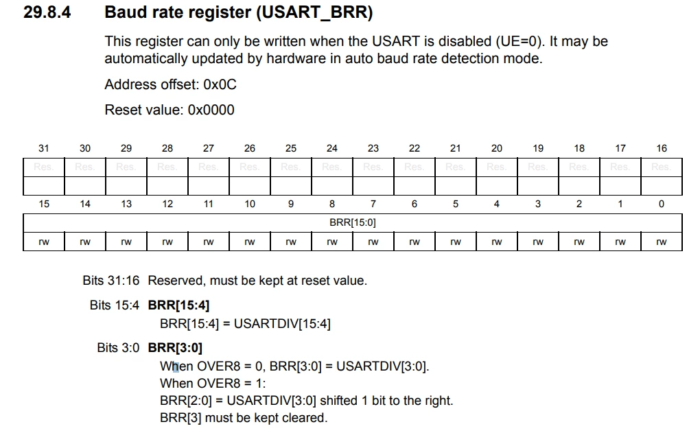

Hi All,
I am currently occasionally receiving corrupted data on my UART2 (STM32F302). By corrupted data I mean receiving a character which I am not expecting.
I am running a 32MHz UART2 Clock and using a baud rate of 9600 with oversampling at 16. So The BRR register should be 3333.33 = 3333
The error should be with the limits I presume. However in the register below I get confused with the BRR [3:0] bits. for OVER 8 = 0 which is what I am using its says that they should be the same as those of the USARTDIV.
Does that mean I should put 3333 in bits 4:15 and put the first 3 bits of 3333 in bits 0:3. Or should I just put 3333 from bits 0:15?
I am currently using the latter method and I am getting some corruption.
Thanks
1 reply
glenn0010
glenn0010Author
May 7, 2019
So I have fixed it. Turns out the Keil C/C++ compiler was set to Level 0. I saw online someone had the same issue and he set it to <default> and it fixed it.
