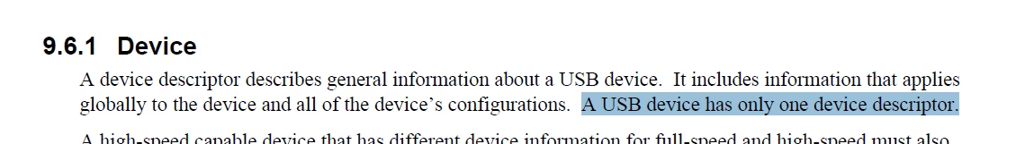

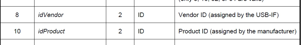

@HH_42 , i don't think that is allowed by the spec of USB
the PID and VID is defined in standard Device Descriptor
and the spec say that  "A USB device has only one device descriptor."
So your a device can not have to PID.
you can verifie the spec here: https://www.usb.org/document-library/usb-20-specification  (9.6.1 Device)
