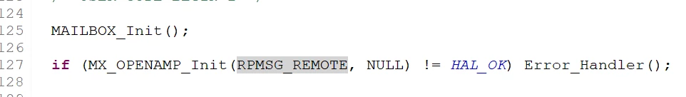

Hi Sir,
My target board is STM32H747 , when I add the code. make will report error. the error message is below , how to fix it ?
arm-none-eabi-gcc -o "TUT_03_CM4.elf" @"objects.list" -mcpu=cortex-m4 -T"D:\STM32CubeIDE\workspace\TUT_03\CM4\STM32H747XIHX_FLASH.ld" --specs=nosys.specs -Wl,-Map="TUT_03_CM4.map" -Wl,--gc-sections -static --specs=nano.specs -mfpu=fpv4-sp-d16 -mfloat-abi=hard -mthumb -Wl,--start-group -lc -lm -Wl,--end-group

So the errors you have are:
  1. undefined reference to `__OPENAMP_region_start__'
  2. undefined reference to `__OPENAMP_region_end__'
They sound like Linker symbols, which would be defined in the Linker script.
Give details of how you created this project; where did you obtain the OpenAmp code?
