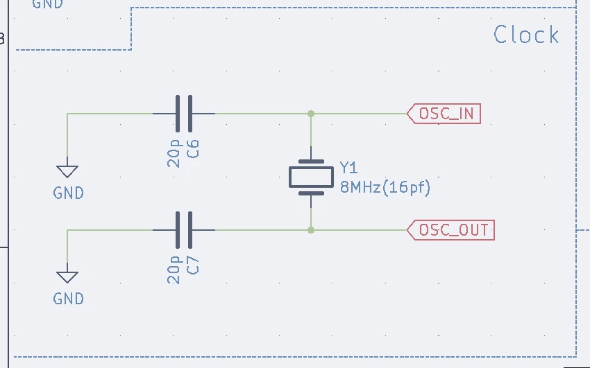

I am having a STM32F401CDU6TR on a custom board and I am not able to run it at 84 MHz SYSCLK. The source is an external 8 MHz crystal with two 22pF caps as seen here:
0693W000008yrF6QAI.png​

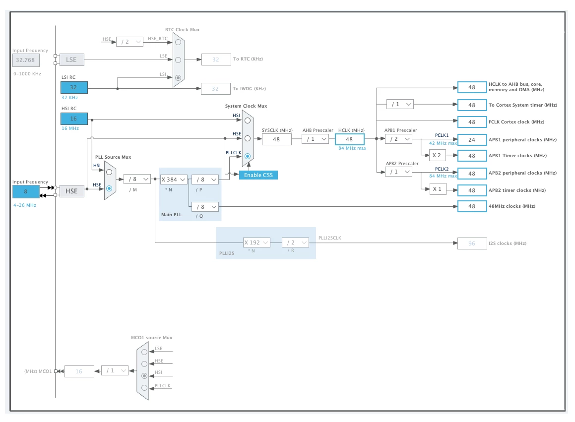

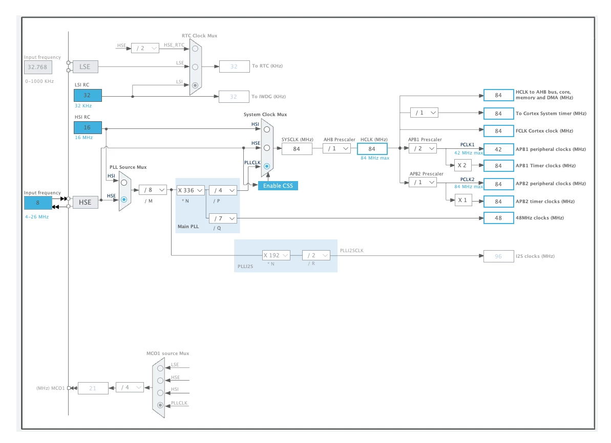

Here is my current 84 MHz clock configuration in CubeMX:

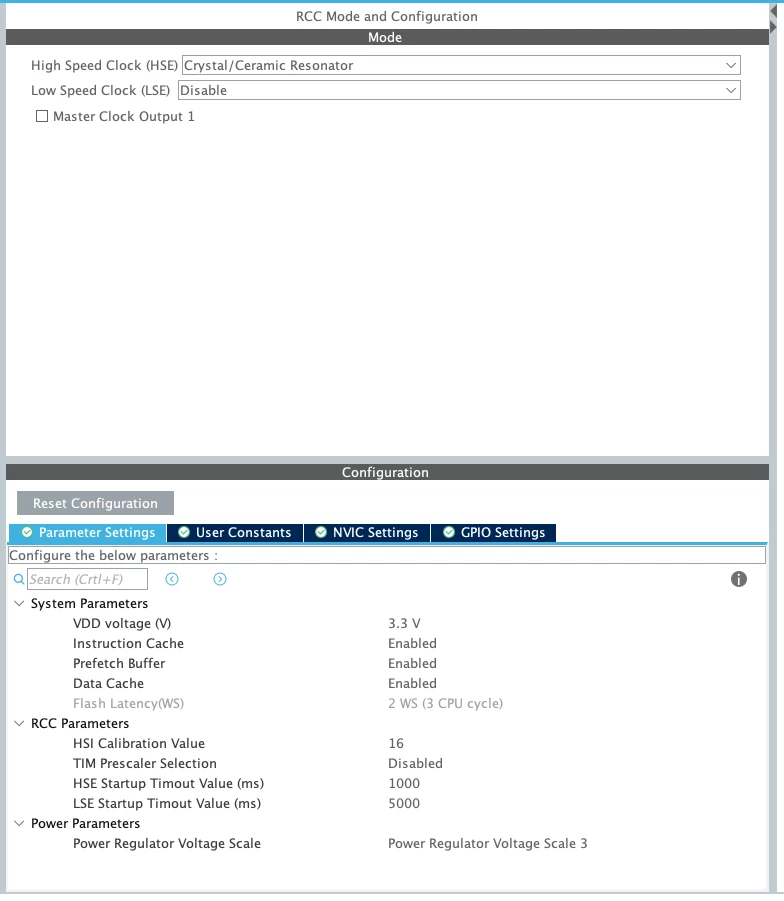

0693W000008yrFzQAI.pngAnd this is my RCC configuration:
0693W000008yrHCQAY.png​
When I flash this code I always end up in a HardFault_Handler before the SystemClock_Config(); function returns.

When I activate MCO1 I can measure the HSE and PLLCLK signals with the expected frequency.
When I set the SYSCLK to 48 MHz as seen here everything works as expected.
I have no idea what is going on here 🤷�?♂�?

"8 MHz crystal with two 22pF caps"
It actually shows 20pF
and the crystal is labelled "16pF"
Is it actually oscillating at all? If it is, is it at 8MHz?

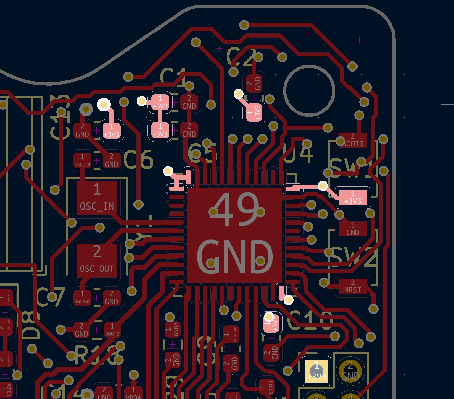

> Do you have adequate decoupling?
I placed 100n decoupling caps across all VDD/GND supply pins around the MCU as close to the MCU as possible.
I might be able to refactor this so the caps are closer. But when I take a look at a nucleo board those seem to be even further away from the MCU.
But I have to admit that my decoupling design could be better. Do you think that is the issue?
Here's a picture of the board layout with the 3v3 net highlighted. Back copper is hidden. Its a 4 layer board.
0693W000008ysIfQAI.png​

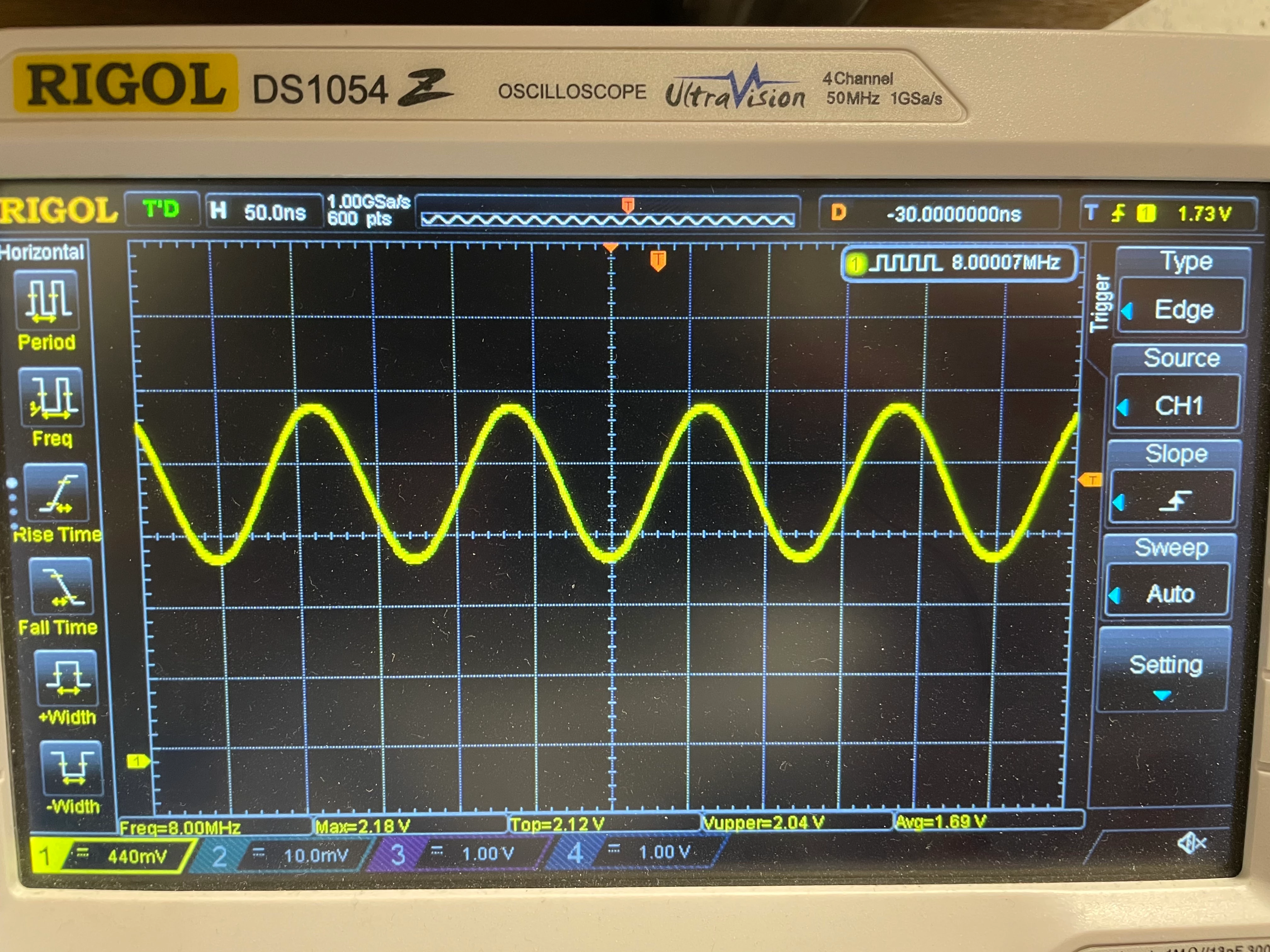

You're right. I meant to say 20 pF. Thats what I have installed.
It is oscillating at exactly 8 MHz. The only thing that bothers me is the voltage peak to peak is a little low, right?
Might also be because I am introducing an error when measuring with my 10x probe.
I measured at one of the crystals leads.
0693W000008ys6FQAQ.jpg​

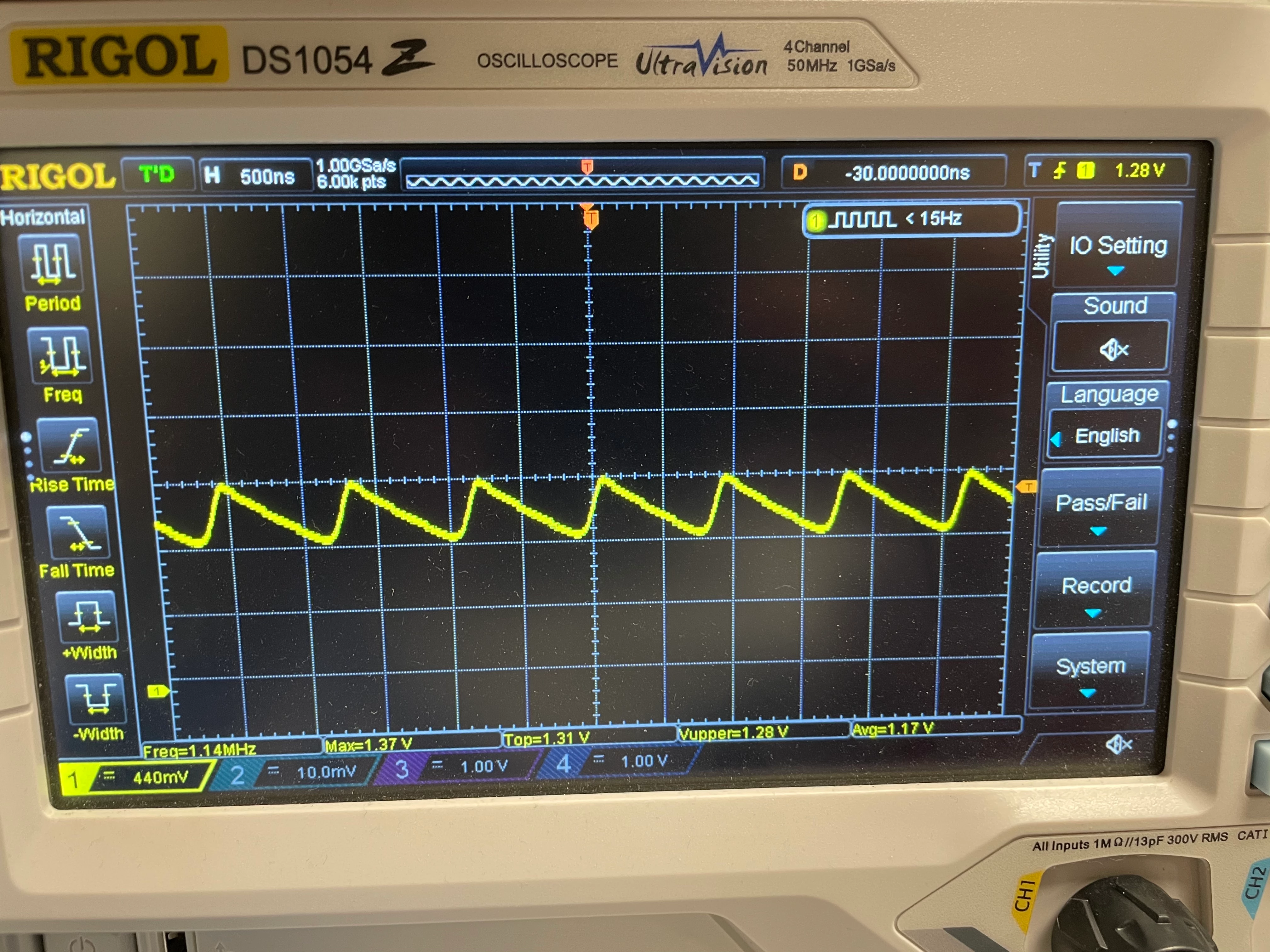

W​hat's going on with VCAP? Check voltage and capacitor value.
Should see 1.25V​

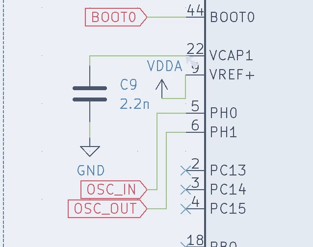

The value is 2.2n as seen here
0693W000008ysXzQAI.png​
Thats what I see when measuring on the MCU facing side of the C9. Seems fine, right?
0693W000008ysY9QAI.jpg​

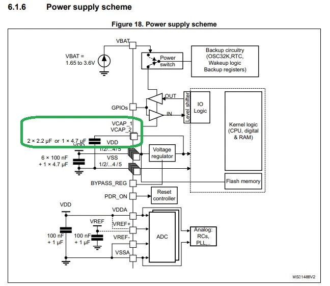

Tesla DeLorean
Tesla DeLoreanBest answer
Guru
April 7, 2021
Should be at least 2.2 uF, it is a bulk capacitor for the internal LDO
I'll double check the specs, the single up case might be 4.7 uF

Oh you are right!
Thats clearly a bug.
Thanks for pointing it out. Will swap that for a 4.7uF one.

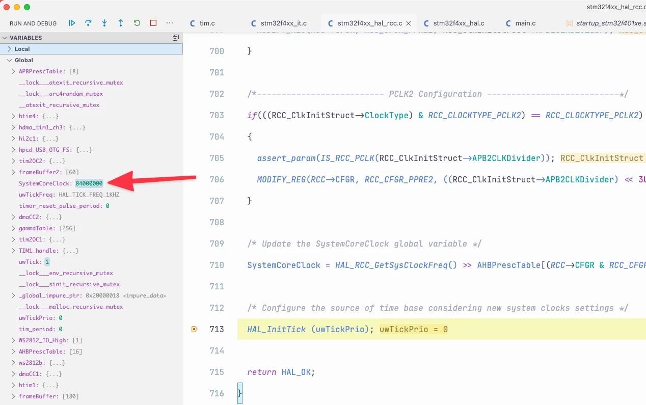

Guys. It works! :party_popper:
The problem was that I took the wrong cap value for VCAP.
I took 2.2nF instead of 4.7uF.
Now, there is no problem anymore with having a SYSCLK of 84 MHz.
