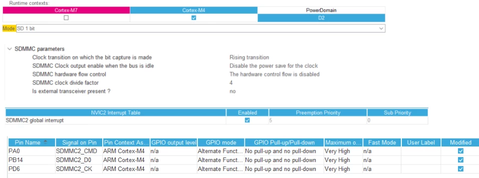

  • I have configured with project in CubeMX to have a sensible SDMMC clock (6MHz) and confirmed it with a scope.

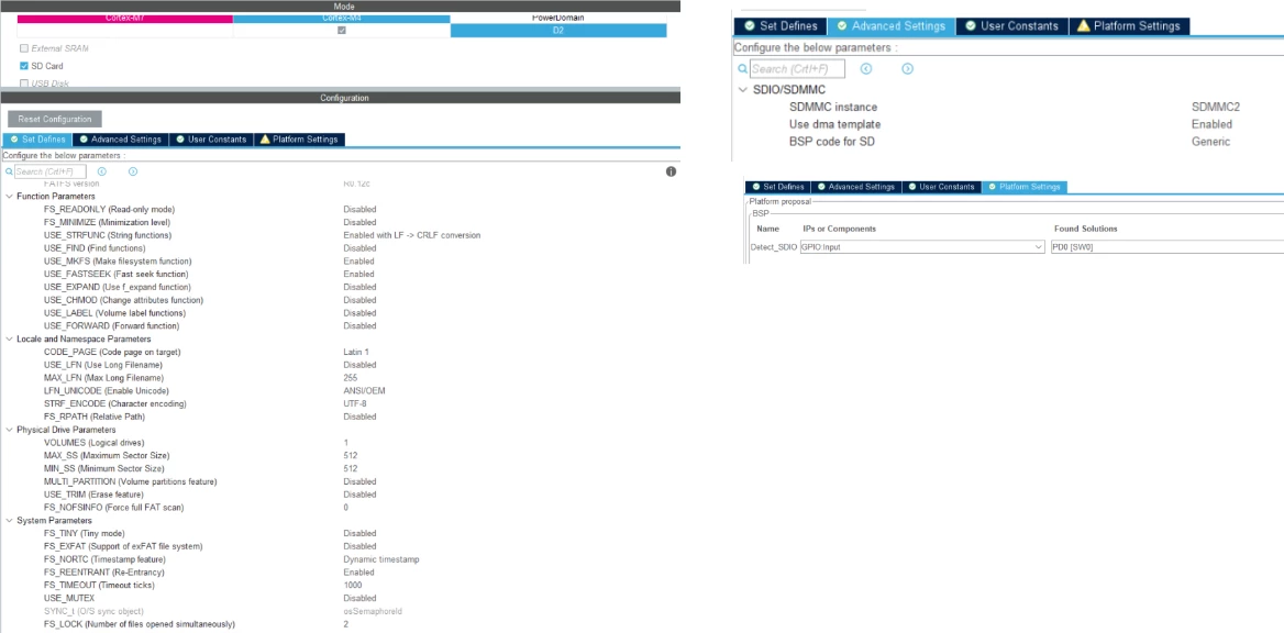

Attached are pictures of my SDMMC2 settings, and my FatFS settings.

  • Checked that SDMMC2 DMA and M4 both have access to all RAM regions
  • Increasing _VOLUMES to 4 in ffconf.h

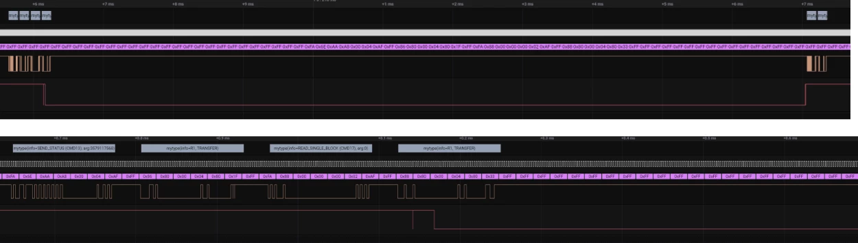

MJack.1
MJack.1Author
Jan 6, 2022 4:52 PM UTC
Thanks for the reply @Community member​.
  • I have reduced the speed of the clock to ~1.5MHz, and set the GPIO speed to fast, and the edges look good on a scope.
  • I have checked that the data buffer used for a read is 32-bit aligned, which it always is.
  • I have checked that the SDMMC2 ISR is called upon completion of a DMA transfer and that the message is added to the queue, which it is.
  • The problem seems to be that when reading from the SD card, the returned buffer is always full of zeros:
I have attached a screenshot from a logic analyser which shows 2 images. The first is the full transaction when trying to read sector 0, and the second is the same transaction but zoomed in to the start so we can see the data. (sorry, it may be a little hard to read)
It appears that the commands are correct (SEND_STATUS followed by READ_SINGLE_BLOCK) and the card responds, but that the SD card pulls the D0 line low for the entire 512-byte sector read. I'm not 100% sure that's what is happening, but that's what it looks like. I have read the fist sector of the SD card using Hex Workshop on my PC, and it is full of correct looking data.
At first I though there was an issue with the DMA, but now I'm thinking something is causing the card to respond with all zeros.
Again, any help would be greatly appreciated.
Matt
MJack.1
MJack.1Author
Jan 7, 2022 12:56 PM UTC
Just thought I would add that the D0 line seems to work correctly for other commands - I can see it toggling in the analyser in response to CMD51 (read SCR register).
Does anyone know why the SD card might be responding with all zeros to a read of sector 0?

MJack.1
MJack.1Author
Apr 5, 2022 3:57 PM UTC
Thanks for the reply, I forgot to update this post and say that I did get it working in the end.
The SDMMC2 clockDiv was configured to set the clock to 3.75MHz after SD initialisation. I wanted to run it slow to rule out PCB issues. I had to up it to 4MHz and it works reliably now. Perhaps <4MHz is out of some spec I'm not aware of?
