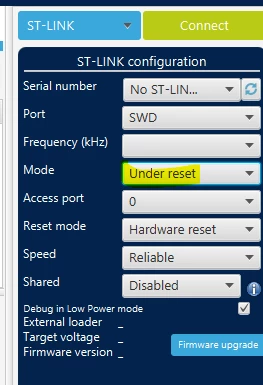

Hello @PSaga.1 ,
It seems like you are entering stop mode and not configuring the correct event to get you out of it try to connect in CubePrgrammer with under reset option and then perform a full chip erase.
Regards
NEdom.1
Jan 21, 2025 3:14 AM UTC
If there is a RESET key, try press and hold the RESET key while start programming.
Wait until you see the connection prompt, release the RESET key and let the programmer to connect to the MCU.
By setting BOOT0 to level HIGH, the MCU boot from internal bootloader other than your app in flash memory. If BOOT0 is set to HIGH and you can't connect to MCU, then check the clock signals.
