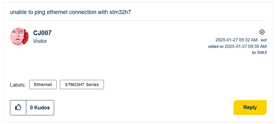

Hello @CJ007 and welcome to the community,
You provided few wording for a relative complex subject. Need to provide more details on you environment: which board? which middleware are you using? LWIP? with without RTOS? etc etc ..
See the tips on how to post a thread.

Hello @CJ007,
Please ensure that your PC and the board are on the same network and subnet.
Additionally, verify that the static IP, subnet mask, and gateway are correctly set in your code.
You can find helpful examples at the following link: STM32CubeH7/Projects/NUCLEO-H723ZG/Applications/LwIP at master · STMicroelectronics/STM32CubeH7

Hello @ASEHST Pc and board are on the same network and subnet. Also the static ip , subnet mask and gateway is correctly set in the code . Ethernet callback is coming and netlink is setup , physical layer  connection is also established , still unable to ping
