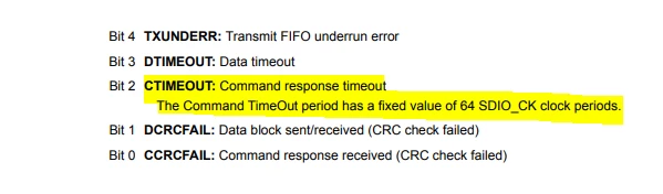

Let me ask a simplified question:
What are reasons for SDIO_FLAG_CTIMEOUT in SDMMC_GetCmdResp1?
Especially with the focus using SDIO with DMA, FileX and USBX together.
As my implementation sometimes (seldom) works, I assume synchronization and priority issues.
Nov 26, 2024 9:01 AM UTC
Hello @Led
The flag SDIO_FLAG_CTIMEOUT is set when a command response is not received within the expected time frame.
The Command TimeOut period has a fixed value of 64 SDIO_CK clock periods. Please refer to the reference manual for more details.
In order to give better visibility on the answered topics, please click on 'Best answer' on the reply which solved your issue or answered your question. Saket_Om
Led
LedAuthor
Nov 26, 2024 9:35 AM UTC
Hi @Saket_Om
Thanks for your reply. The questions remains what are the reasons for it?
With debugger I see
- In SDMMC_CmdReadSingleBlock() a command is sent to SDIO
- Then SDMMC_GetCmdResp1() is blocking-waiting for an answer.
Why should the answer not come? Knowing that writing via USB works, but writing via FileX does mostly not work.
