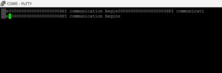

Unable to implement SPI in STM32H563ZIT6 as master and Arduino Uno as Slave
I am trying to use H5 as master and UNO(ATmega328p) as slave and transmit data from UNO and receive a character & print it in the COM using USART3. The baud rate I've set for both is 4 MHz.
By connecting them together and I can see that the "Tx " LED in UNO is blinking but I can't figure out why there is no sign of my master receiving any data from the slave.
This is my master code:

This is my slave code:
#include<SPI.h>
#define SS 10
#define MISO 11
#define MOSI 12
#define SCK 13
void setup() {
 // put your setup code here, to run once:
 pinMode(SS, INPUT);
 pinMode(MISO, OUTPUT);
 SPCR |= _BV(SPE); //This simply sets the SPI peripheral enabled, but doesn't set other fields to master mode like SPI.begin()
 SPI.setClockDivider(SPI_CLOCK_DIV2);
 SPI.attachInterrupt();
 Serial.begin(115200);
ISR(SPI_STC_vect){
 SPDR = 0;
 Serial.println("Data Transferred");
void loop() {
 char tx_buffer = 'F';
 if(digitalRead(SS)==LOW){
 SPI.transfer(tx_buffer);
The output I'm getting in PuTTY is:
Kindly help me figure this out :)

Hello @vnibinv_03 ,
You can use the SPI example for your H563ZI board on GitHub to help with your issue: STM32CubeH5 SPI Example.
This should assist you in setting up SPI communication properly.
Best regards.
