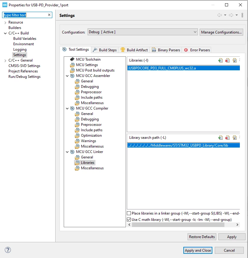

The USB-PD lib is not compiled with your project. To add it, follow the settings like this picture:
Regards
Yohann
ssara.1
ssara.1Author
October 13, 2021
Thank for your answer Yohann. But seem like the project setting is already set the same as your picture.
Is there any other setting I need to change?
Yohann M.
October 13, 2021
Hello @ssara.1​
You should see this lib into your linker command:
arm-none-eabi-gcc -o "USB-PD_Provider_1port.elf" @"objects.list" -l:USBPDCORE_PD3_FULL_CM0PLUS_wc32.a -mcpu=cortex-m0plus -T"....Applications\USB-PD\USB-PD_Provider_1port\STM32CubeIDE\STM32G081RBTX_FLASH.ld" --specs=nosys.specs -Wl,-Map="USB-PD_Provider_1port.map" -Wl,--gc-sections -static -L../../../../../../../Middlewares/ST/STM32_USBPD_Library/Core/lib --specs=nano.specs -mfloat-abi=soft -mthumb -Wl,--start-group -lc -lm -Wl,--end-group
It is not the case in your log.
