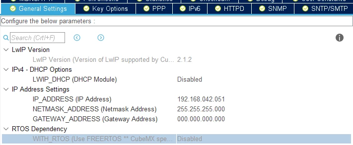

UDP Echo server example is not working(Nucleo-144 for STM429ZI)
I used example from STM324xG_EVAL\Applications\LwIP\LwIP_UDP_Echo_Server\Src.
I add lwIP into the project using CubeMX.
ping test is good.

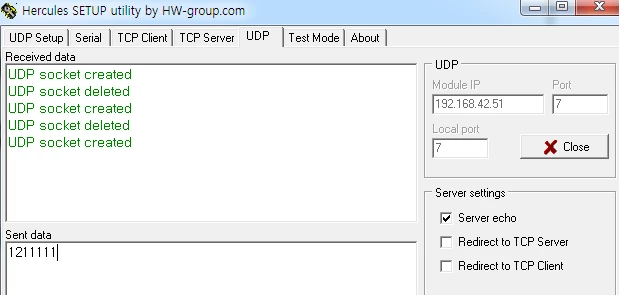

I sent the message using Hercules tool. but Necleo didn't receive massages .
​0693W000000Wop3QAC.png​

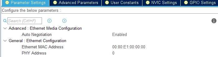

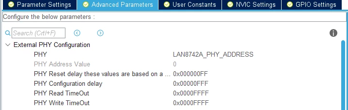

there are CubeMX setting value.
I also change GATEWAY ADDRESS to 192.168.42.1, not working too.

​I want to work udp_echoserver_receive_callback fuction when I send a message.
Piranha
PiranhaBest answer
Principal III
May 4, 2020 8:24 AM UTC
You are calling udp_echoserver_init() before MX_LWIP_Init(). :)
Also be warned...

BPark.4
BPark.4Author
May 4, 2020 12:28 PM UTC
Thank you.
I modifed it under MX_LWIP_Init(). and I can receive the message.
