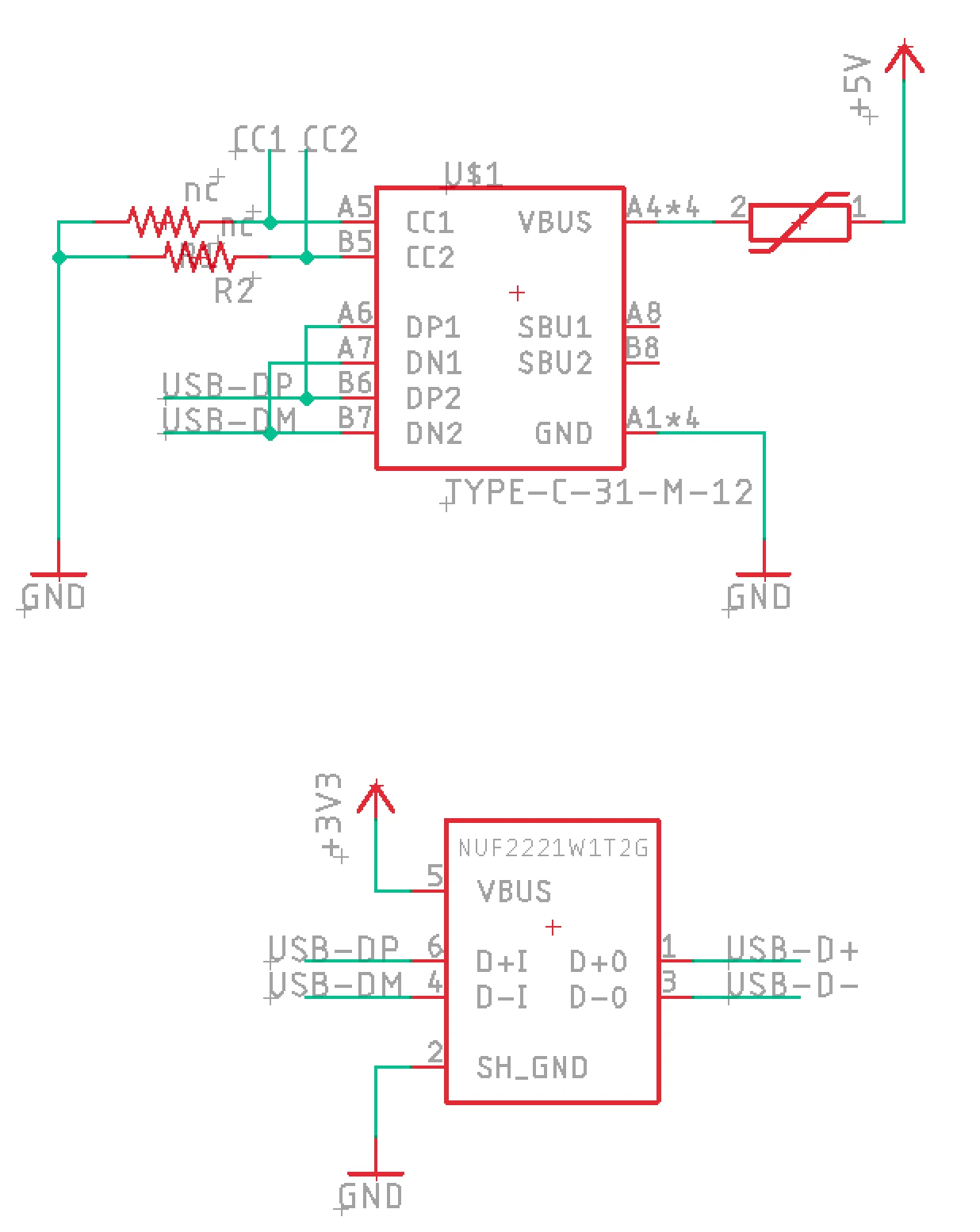

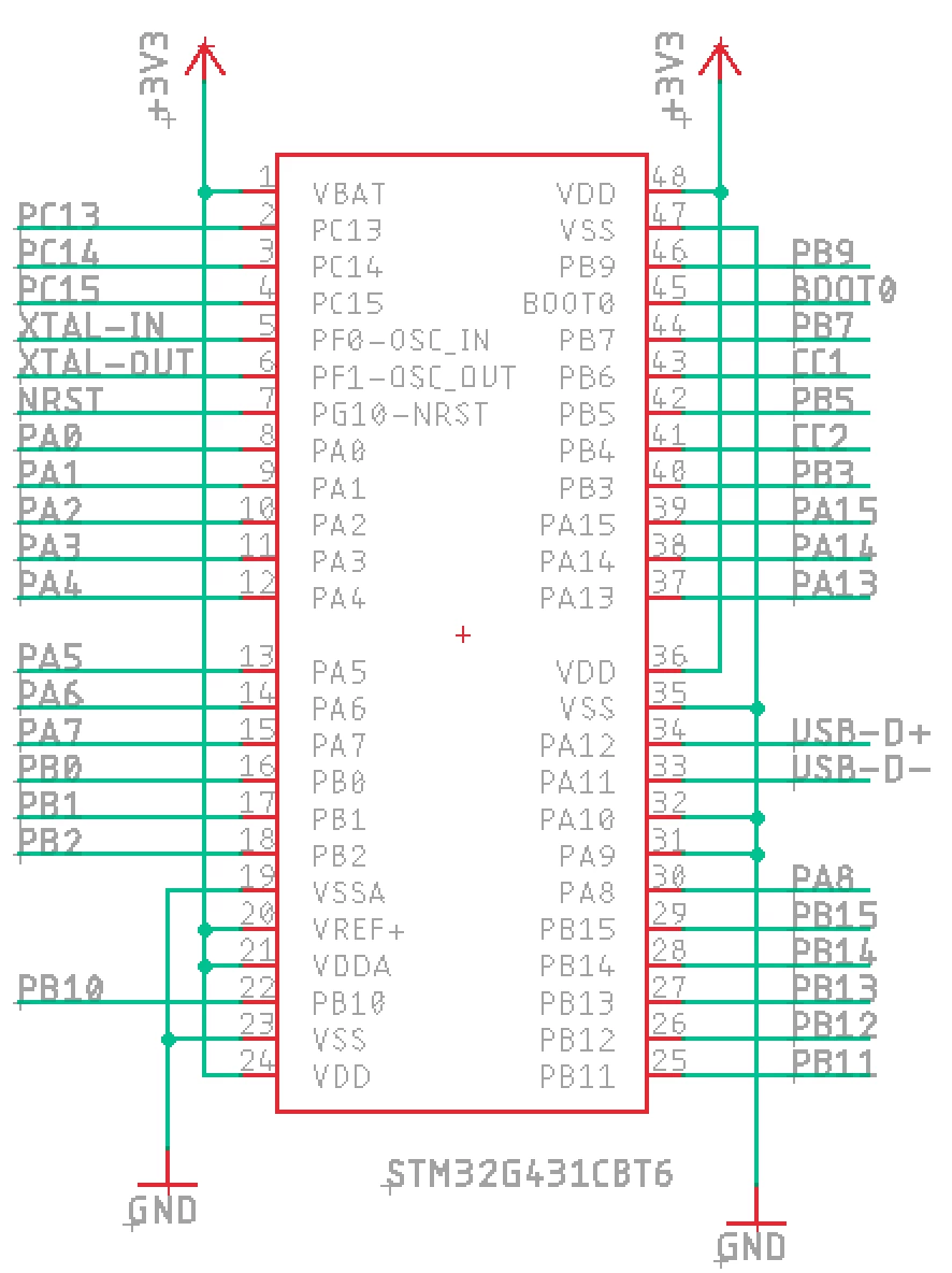

UCPD sink with external pull-down resistors?
Hey,
the STM32G431 data sheet states that the UCPD unit has internal pull-down resistors. Now I want to flash my G431 via DFU, and USB-C doesn't provide power to a sink unless CC1 and CC2 are pulled down.
It seems that the internal UCPD only works when the MCU is flashed; can I use the internal UCPD with external resistors on CC1 and CC2? This seems to be required to flash the MCU via DFU the first time;
Can I still use the UCPD of the G431 in this case?
