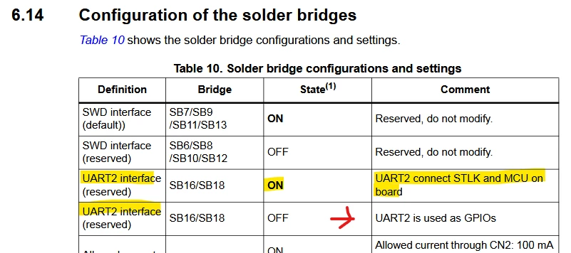

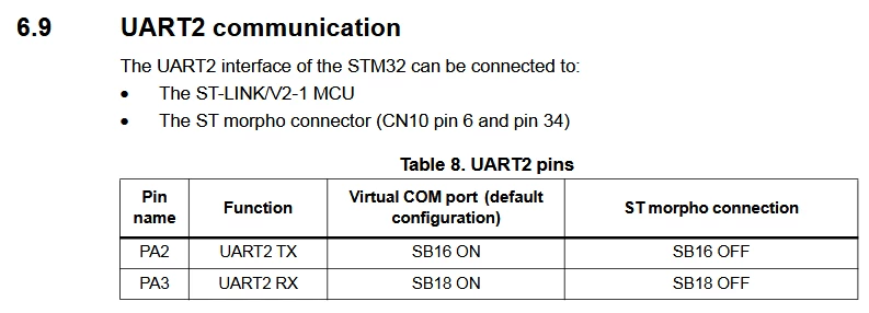

Hi @MathewANTHONY ,
You are mentionning STM32G070RBT6 in your description, are you using the NUCLEO-G070RB board ?
If yes, please note that USART2 TX and RX pins, might be connected to ST-LINK, for VCP communication and not to morpho connectors. You should be able to change this by updating Solder bridges configuration.
Please refer to User manual of STM32 Nucleo-64 boards (MB1360) UM2324, and especially at those paragraphs :
Hope this helps.
