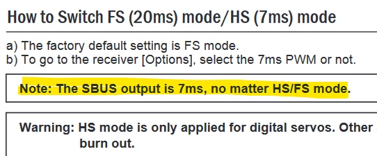

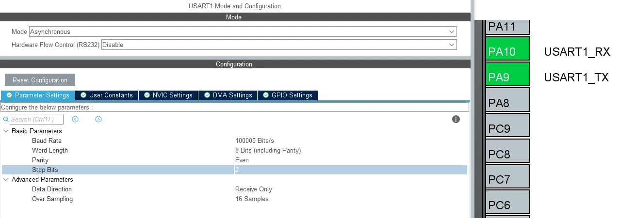

Iv'e tried it with 9 or 8 bits word length, but that doesnt change anything. Since FrSky is using the Inverted-SBUS, which is inverted itself (0->H, 1->L), I figured the data polarity is correct aswell as the jumper wires and config settings on the RX.

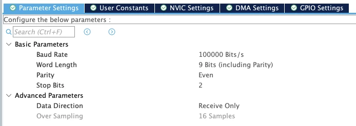

    Hello @JGiem.1 ,
    Are you sure that 100000 is the correct Baudrate? for the UART configuration i also would recommend to have a serial analyser to get the output of the controller to make sure that it is sending the buffers.Also you can try to change the UART instance as it can be used for other purposes on your board check in there is any other hardware configuration (solder bridges and so on ).
    I recommend at first to ensure that the UART communication is established and from there you can continue your development .
    BR

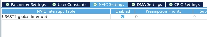

    You haven't show any code that shows you've put the UART receive in interrupt mode?
    If a reply has proven helpful, click on Accept as Solution so that it'll show at top of the post.CAN Jammer an open source CAN bus hacking toolCANableV3 Open Source
    JGiem.1
    JGiem.1Author
    Jan 9, 2024 9:03 PM UTC

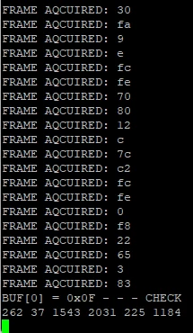

    Thank you for explaining how to use the Interrupt structure, I think I understood it a little deeper now. Out of curiosity, is there a document that explains the functionalities and especially their structures (when to incorporate what or which purpose) of the HAL library a little better than the "Description of STM32F4 HAL and low-layer drivers (UM1725)" ? Had several issues when it comes to applying stuff I read in there.
    Moving on - I copied your code, inserted my conversion snippet and tried it out:
    It seems like most of the time, nothing changed too much - it's still picking up mostly random values. But by moving the sticks on the transmitter, I can occasionally (and not repeatedly) provoke a "valid" frame that leads to conversion and value output. To be fair, that worked before, too.
    What I don't understand is this: SBUS is originally "inverted" to 1=LOW (confirmed by two independent sources, yet another one says the opposite). FrSky apparently chose to invert SBUS again to what I figure is 1=HIGH. As per definition, UART is 1=HIGH aswell so I should not  need an inverter. It seems like the MCU does receive frames via UART, it just somehow is missing the "00001111" flag as Byte1 of the frame or buf[0] in my code. Is there anything to this I am still missing?
    A variant that doesn't check for the start flag and just converts the input to its according SBUS values doesnt give me conclusive behavior:
    If filtered by buf[0]=0x0F, the occasional result yields no better values.
    Is it maybe signal degradation due to the baud rate being 100k and the bread-board cable I use between the Rx and the STM32 being 20cm long?
    Am I totally wrong about UART and indeed do need to use an inverter?

    can you try to set the UART Baudrate to another value and check if you get the same results on putty also i suggest you change the cables used for the connection and try to visualize the effect as i quote that "But by moving the sticks on the transmitter, I can occasionally (and not repeatedly) provoke a "valid" frame that leads to conversion and value output."so this should not be the case if every thing is set up correctly.
    BR

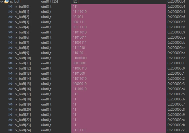

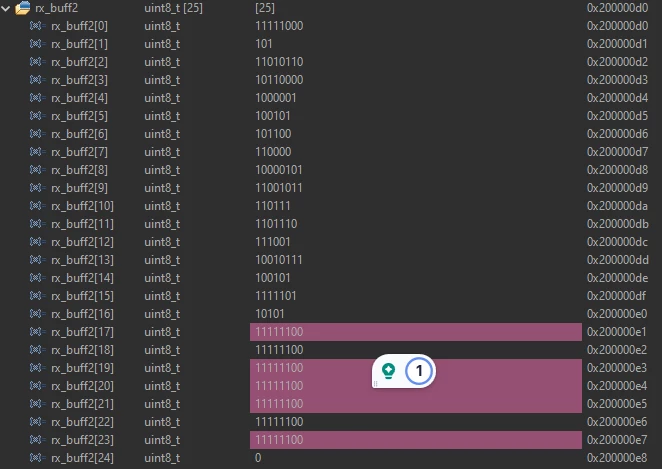

    Jan 19, 2024 1:26 PM UTC
    I have been experiencing a similar issue with a different receiver.
    I think that you are receiving an inverted signal.
    I suggest changing the data visualization to bits for a better understanding of the problem. In my case, I received consistent buffer data that looked inverted, but some channels where overlaping.
    Inverting the bits by software also resulted in incorrect data.
    The processor is taking the wrong bits as header, parity, and stop. Moving the joysticks on the remote controller changes these bits, causing the data stream to shift and disrupting the order of the repetitive patterns.
    If you get something similar, you will need an external hardware inverter. A simple transistor will be enough.

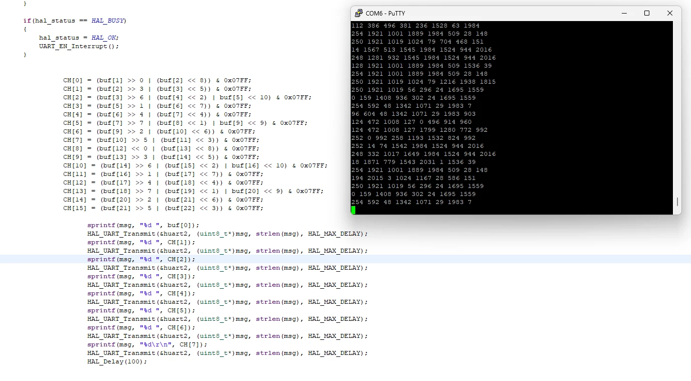

    So today I had the time to try out the inverted signal. Buckle up.
    I am inverting the signal with a p-ch MOSFET (IRF5305) using this example and verified it working as expected by testing it with an LED (Gate HIGH = Led LOW; Gate LOW = Led HIGH; 3.3V Logic Level). The gate gets discharged via 10k to GND, but leaving it away made essentionally no difference.
    I tried both, inverted and uninverted input from the receiver to the F446.

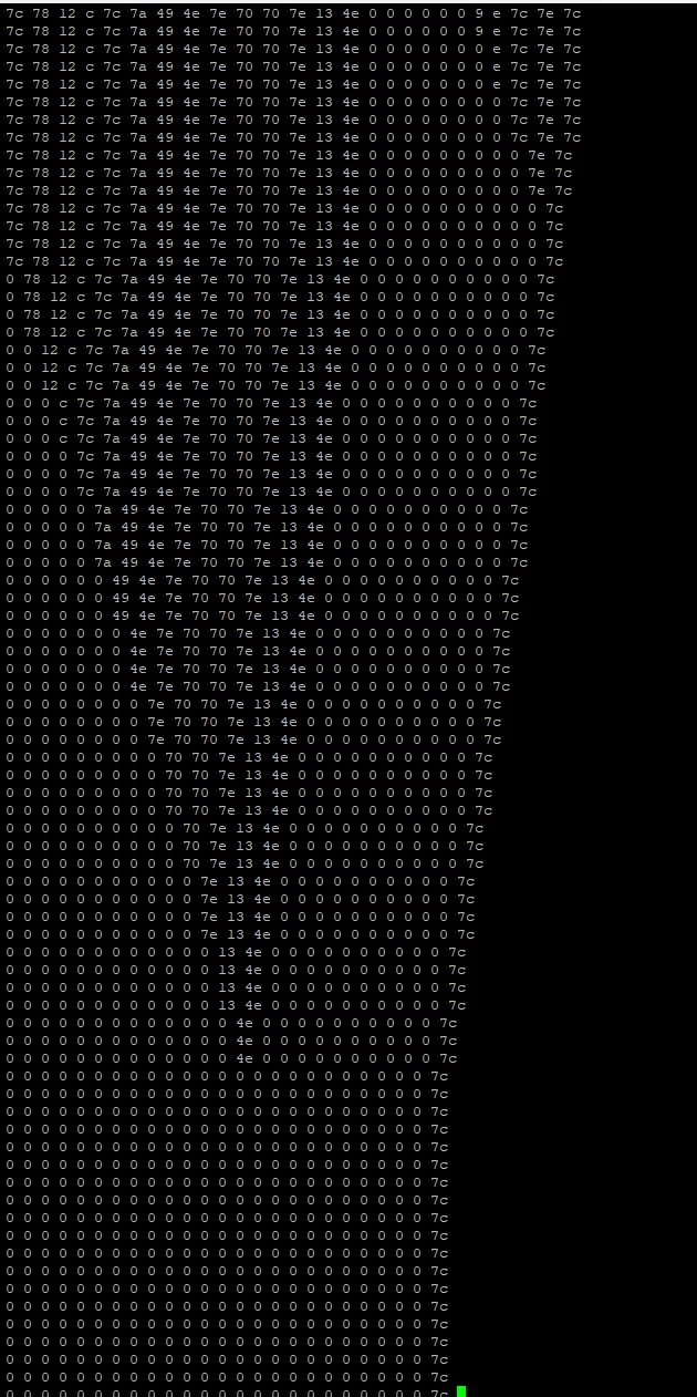

    @Karl YamashitaThe appearance of patterns that seem to shift stopped when reducing the RX buffer size to 24 instead of 25 bits. Note that in most SBUS tutorials that seem to work it is being worked with 25 bytes as frame size. But the shifting disappeared and you can now clearly see when you move a stick on the Tx that the approximate index of the frame (where the channel value is stored) differs from the one before. Meaning, moving the Throttle input (as CH1), it changes the frame from the beginning whereas when I am moving Aileron (on CH4) the difference in frames is only noticeable further to the end of the 24 byte hex output. I want to stress that while this looks "more right" it is actually against what can be read about SBUS (25 byte frame size). Could the fact that one byte is "missing" be an effect caused by some intricacy in the way HAL UART works?
    Working with 8 bits incl. parity results in said "clean" appearance, whereas with 9 bits incl. parity you have it shifting again - that was more of a "why not try it"-idea but kinda confirmed the apparent frame length of 24 not 25 byte.
    9b. incl p. and 25byte frame size resulted in the shift too.
    Inverting the signal did change the output in its values, but it still only occasionally recognizes the starting flag (0x0F or dec 15), preferably with throttle (CH1) in the lowest position and the rest centered. The effects I first described above could be observed wether inverted or not.
    Just an example of how the output looks like:
    Taken while moving a stick.
    @danielscmThanks for your ideas. As described above I went to work and unfortunately did not yield the same results as you seem to have gotten - may I ask what receiver you are using, and wether it was made by FrSky (with their own little interpretation of SBUS)? Inverting the signal seems to not make huge difference, it still can't catch the start flag and in the rare event that it does, the given values for each channel are not realistic (given that ~1024 is the middle value for 3 of 4 actively monitored channels and that value never remotely appeared). Unfortunately I will yet have to read into making the bare binary numbers visible. Will update.
    @STeaRegarding the logic analyzer, I was having some compatibility issues that need fixing as to be able to use it properly. I was unknowingly locked down to 20kHz which is way too slow for a 100k baud signal. Will update.

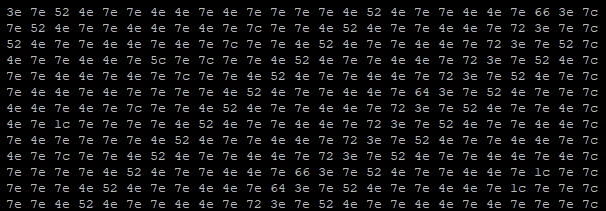

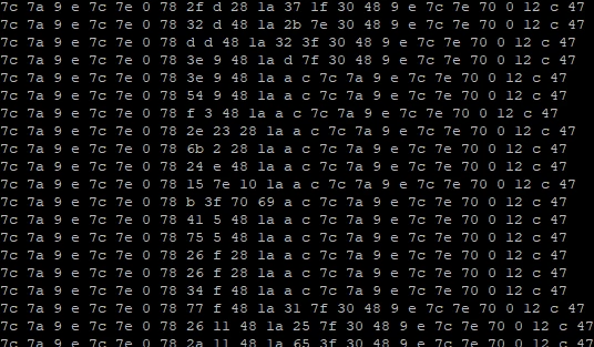

    Last but not least I want to tell you about two more phenomena I observed that I can't make anything out of.
    1) After turning off the TX the receiver is entering failsafe mode where it is instructed to pass on "no pulses"; It feeds this:
    It's a pattern that again appears shifted again regardless of 24byte-frame size, with the 7c in the end being a constant. Remember this for 2)... Unfortunately, the manual does not go into detail as to how the "no pulses mode" behaves. Out of a forum of OPENTX (the transmitters firmware), I get something along the lines of "No Pulse: on loss of signal the receiver produces no pulses on any channel. To use this type, select it in the menu and wait 9 seconds for the failsafe to take effect." - whatever that means for the SBUS output.
    2) When disconnecting the RX from the F446's input (D2) something remarkable happens:

    //PRINT EACH CONVERTED CHANNEL VALUE IF START FLAG WAS FOUND
    	 sprintf(msg, "%d ", buf[0]);
    	 HAL_UART_Transmit(&huart2, (uint8_t*)msg, strlen(msg), HAL_MAX_DELAY);
     sprintf(msg, "%d ", CH[1]);
    	 sprintf(msg, "%d ", CH[2]);
    	 sprintf(msg, "%d ", CH[3]);
    	 sprintf(msg, "%d ", CH[4]);
    	 sprintf(msg, "%d ", CH[5]);
    //SO ON AND SO FORTH
    	 sprintf(msg, "%d ", CH[23]);
    	 sprintf(msg, "%d ", CH[24]);
    	 sprintf(msg, "%d \r\n", CH[25]);
    //MAKE IT NOTICEABLE
     HAL_Delay(10000);
    Now as far as I'm aware, the UART is working with an Interrupt to fill the buffer so it probably wont be interfering with the transmitting to the serial terminal (please correct me if Im mistaken).
    First things first: Despite the frame now theoretically only consisting of "0" due to no signal, it yields the 7c (124 in dec) in the end of it - any ideas why that is?
    But most importantly: Note the slow and not - as I would have expected it - instantaneous changing to 0 of the frame's bytes after disconnecting! (Discharge resistor applied to the MOSFETs Gate doesnt change anything).
    Is there a reason for that in the code or could that be residual signal somewhere along the wire (can't be a real thing)? This is becoming way trickier than I thought it could get. Is it a timing issue in my communication? Any ideas as to why this happens?
    Lastly, in the Receivers manual, i found this snippet of info:
    Along with an email address of the technical support, which by now I am frustrated enough to contact for further info on the SBUS output. Wether this is changing anything or not is beyond me right now.

    Hello @JGiem.1 ,
    i have some suggestion you can try:
    1. "Note the slow and not - as I would have expected it - instantaneous changing to 0 of the frame's bytes after disconnecting!" to flush the UART buffers using fflash (0); after each print to see the affect on the displayed results on the terminal because this is apparently a sync issue delaying the instant clearing of the buffers after unplugging the RX pin
    2. Move the
      UART_EN_Interrupt();​
      after
      HAL_Init();​
    3. try a different UART instance (switch UART1/2) and see the effect of it on your following comment"1) After turning off the TX the receiver is entering failsafe mode where it is instructed to pass on "no pulses""
    BR

    I have had the same problem of trying to decode SBUS the past couple days and I have managed to get it to work (mostly, more about that at the end of my post).
    First let me start by saying that SBUS is always inverted, no matter if you have a Futaba or FrSky receiver. So you will always need an inverter for the F1 or F4 series. But building one from two resistors and an arbitrary NPN transistor is very easy and you should be able to find the parts almost anywhere.
    There are some receivers where you can access the non-inverted signal by opening the rx and tap the signal before it gets inverted. The only exception might be some truly ancient receivers that I am forgetting right now, but for all others that should be true.
    That said, your screen grabs are actually showing a non-inverted signal, which is a little bit odd... What receiver are you using and have you tried a different one yet?
    Now down to business of decoding the SBUS signal. For the sake of completion for people finding this post later I will include absolutely everything, because I myself am just starting with the STM uCs and many things are not as obvious as we think.
    First you want to start by setting up the USART (I used USART2) with a baud rate of 100000 Bits/s, word length of 9 Bits (inc. Parity) , even parity bit and 2 stop bits. Additionally don't forget to turn on the global interrupt in the NVIC settings, been there done that and wondered why it didn't work...
    I also set up USART1 to print the frames and processed data over serial.

    Bolder Flight Systems also mention that "FrSky receivers will output a range of 172 - 1811 with channels set to a range of -100% to +100%.", which is exactly what I'm getting with a FrSky XM. I haven't tried any other receivers yet, but they should all work the same.
    Now, as mentioned earlier I'm just starting out with the STM uCs and therefore don't really know what I'm doing. There is one problem, to which I haven't figured out the solution yet:
    Depending on when the uC starts up the first byte received might not be the starting byte of the SBUS transition. You can trigger this by pressing the reset button a couple times; at some point you'll run into the issue.
    The question is how to solve this. I need a way to basically to reset/reframe when the interrupt gets triggered whenever the first frame is not the SBUS header (0x0F). I'd really appreciate if somebody could guide me in the right direction!
