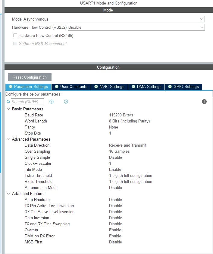

I'm trying trying to setup an interrupt receive on the U5 MCU using the STM32U5GJ-DK2 development kit. The USART1_IRQHandler does not get triggered at all. Here's my CubeMX config for the USART1:
I've sniffed the RX line, so I'm sure it's working as expected.

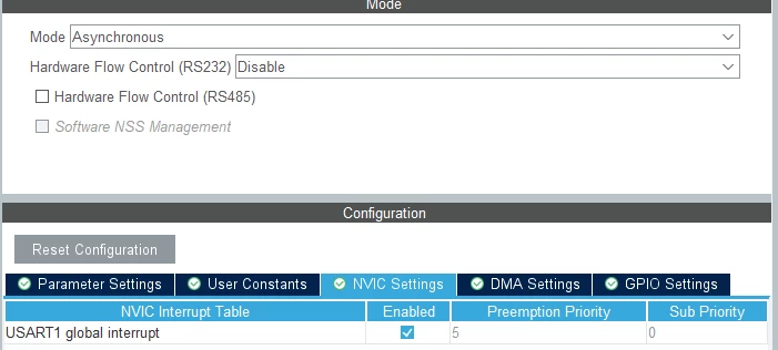

Apr 2, 2024 12:08 PM UTC
Hello @Dobrev
Is the UART global interrupt enabled? If not try to add the line bellow in HAL_UART_MspInit.
HAL_NVIC_EnableIRQ(UART4_IRQn);
Best regards
Omar
In order to give better visibility on the answered topics, please click on 'Best answer' on the reply which solved your issue or answered your question. Saket_Om
