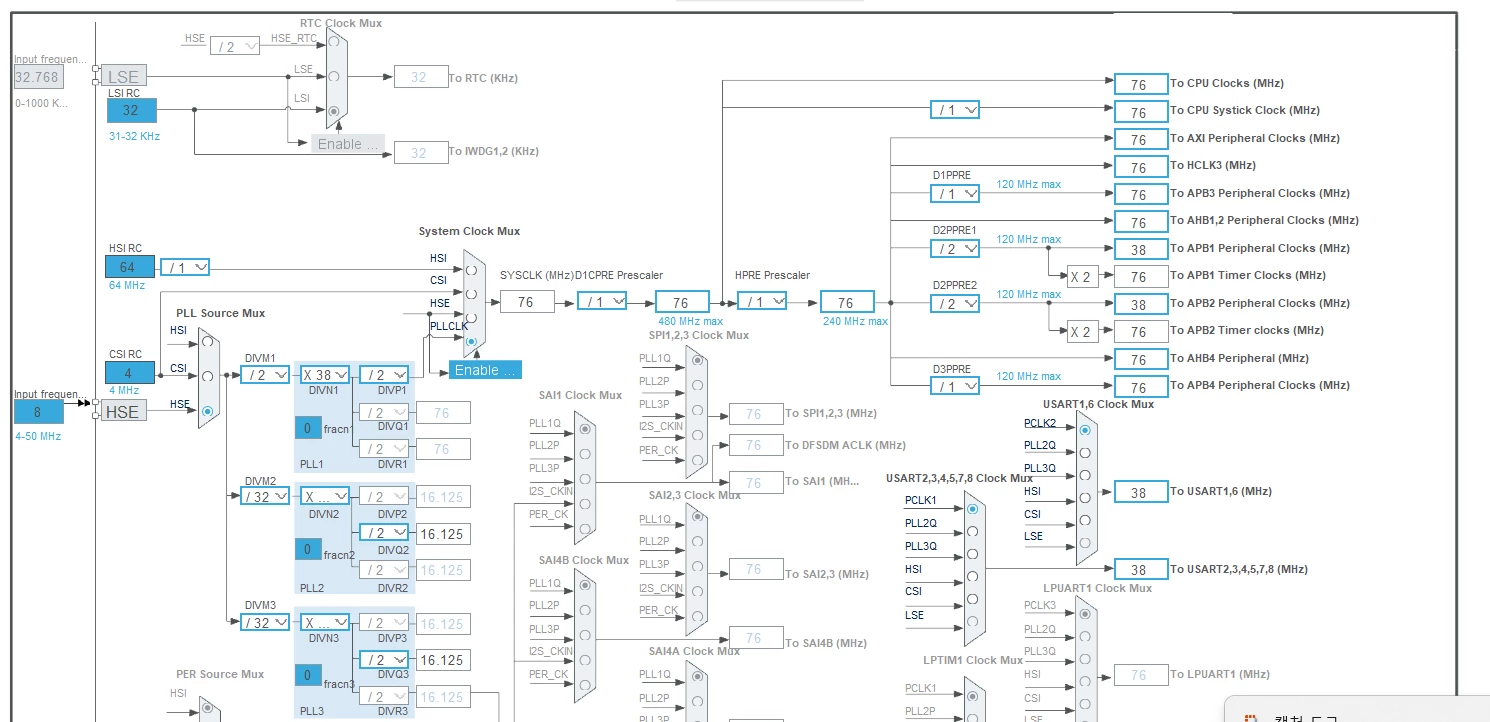

I'm adding the Clock Configuration screenshot that I missed in the original post

Before going deeper into the MPU, check with logic analyzer whether USART6 is actually transmitting what you think, independent of MX-series motors.
