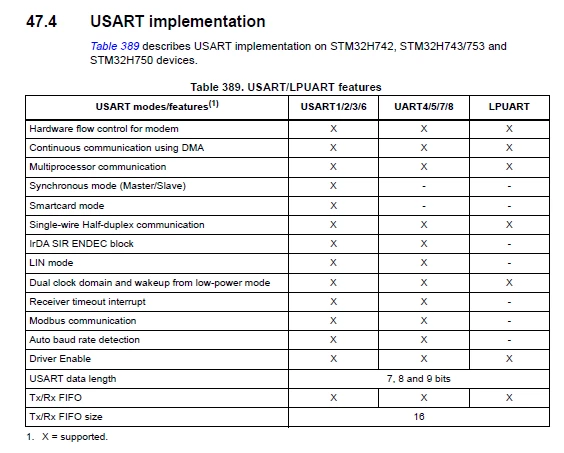

UART or USART in Cube libraries ?
So even newer STM32s still have both of UARTs and USARTs.
My question is about how they are going to be supported in Cube libraries.
Am dealing with H7x3 recently, and noticed that the UART example actually is for USART - as the serial connector on the eval. board is indeed USART1.
https://github.com/STMicroelectronics/STM32CubeH7/blob/e261d820b398846a94f22f4aeb32d86c29546efb/Projects/STM32H743I-EVAL/Examples/UART/UART_HyperTerminal_IT/Inc/main.h#L33
I've played with the example as is, and it works. Then out of curiosity I've changed all uses of "UART" lib API there to USART (added hal_uart.c, ...uart_ex.c to the project...) and RX interrupt no longer works. Output works well.
It does not get any singe RX interrupt.
In my real project both UARTs and USARTs will be needed.

Tilen MAJERLE
Sep 7, 2019 12:34 PM UTC
Differences between UART and USART hardware IP are described in reference manual, see snapshot:0690X00000AQst7QAD.png
USART has additional option to support synchronous communication with clock generation.
You can use HAL UART module for all UART or USARTs when these are NOT used in synchronous mode. Otherwise, you need to use HAL USART module.
So for you, unless you use synchronous mode [with clock], you can use HAL UART module with all 8 U[S]ARTs in the project. All have option for HW flow control.
Hope it is clear.
Tilen
