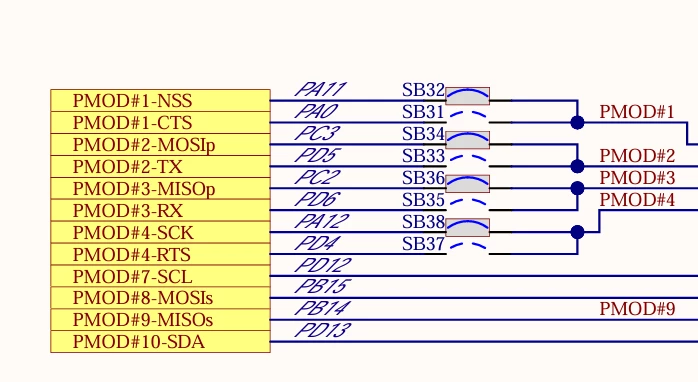

I suspect there might be a race condition where the looped-back byte arrives before the MCU has fully finished the TxCpltCallback and armed the Receive_IT. Is this a known issue?

In the schematics cutout, the red crosses are unpopulated solder bridges.
Like the one that could connect pin PD5 to PMOD#2. The numbers are hard to guess, indeed.
Found a better one for rev. D04 here: https://www.st.com/resource/en/schematic_pack/mb1248-h747i-d04-schematic.pdf
so you have to open SB34 and to close SB33 for that.
Similar, open S36 and close SB35 for PD6 connection to PMOD#3.
Unfortunately, they are not mentioned in the UM2411 user manual, couldn't locate them on the board.
Double check with the board docs before turinng the soldering iron on.
hth
KnarfB

thank you for your answer. I have implemented the code as you suggested. This code saddly does not work also.
Regarding: "Additionally, I recommend checking the error flags that lead to the invocation of Error_Handler(). Understanding which flags are set when the error occurs can help pinpoint the root cause." Every error flag that is thrown is an ErrorCode of 4.
Im suspecting my issue is on the hardware side. Do I have to close/open any solder bridges on the STM32H747I-DISCO  to enable UART communication over the STMod connector? Im pretty sure my configuration in CubeMX is correct.

The ErrorCode 4 corresponds to HAL_UART_ERROR_FE.
Could you try with lower baud rate please?
Could you check the quality of your hardware connection?
