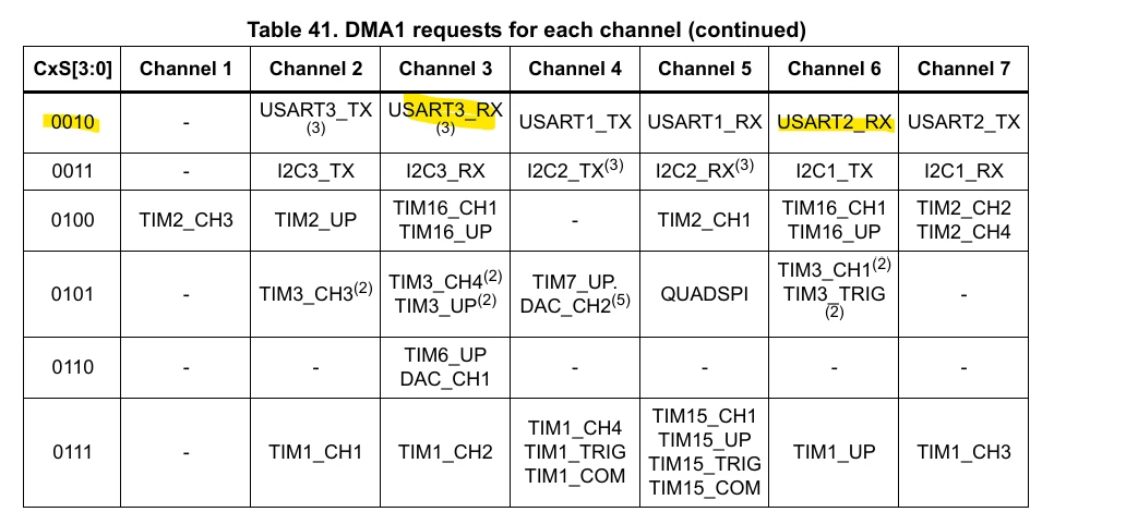

I have two concurrent UART DMA RX running in STM32l431.
UART2 is running all the time and UART3 is started when a command is sent and waiting for data.
Both of them works, but when I try to make a new DMA transfer on one of them the other stops which I do not want. Why does this happens?

LCE
Principal III
Aug 7, 2026 13:02 UTC
You set both DMAs to the same request number, that correct?
hdma_rx2.Init.Request = DMA_REQUEST_2;
hdma_rx3.Init.Request = DMA_REQUEST_2;
RFlod.2
RFlod.2Author
Senior
Aug 7, 2026 13:12 UTC
My understanding is that it is correct
 But again, ST DMA registers are confusing
LCE
Principal III
Aug 7, 2026 14:49 UTC
Okay, then it’s correct.
