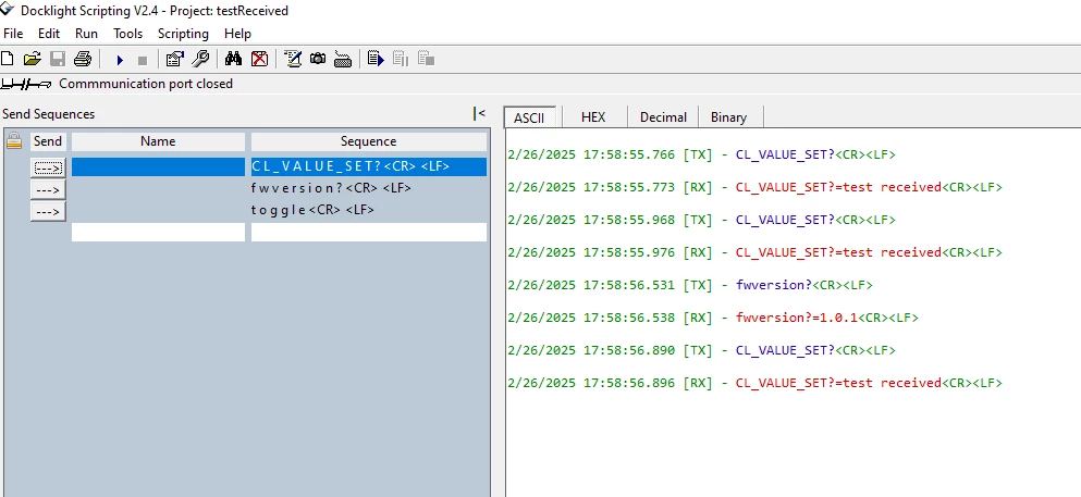

This is the code I am currently using. At the moment once it receives a message it's meant to scan through and check for a '?', if it does see this it responds with 'test received' and then loads the received buffer into another buffer before sending that back. When I use PuTTY to send messages I get these responses.
The message sent is CL_VALUE_SET? I get a good response for the first message, the second time I send a message I don't get any response and the third time it doesn't see the ? it seems.

Karl Yamashita
Feb 27, 2025 2:08 AM UTC
First, you enabled the UART interrupt for 10 bytes but your CL_VALUE_SET? is 13 bytes, or 14/15 if your console send CR and/or LF. For explanation on what's happening, we'll  just assume your console sends a LF after the text.
So the first interrupt your buffer will have CL_VALUE_S because you set to receive 10 bytes. You set the flag for uart_received, but where do you check for the flag? Anyways.
Then you enable interrupt again, but for 30 bytes. But the UART is currently filling the buffer with the rest of the text, ET?\n but you won't get an interrupt yet because you are waiting for 26 more bytes.
However, in your while loop you iterate through the 30 bytes and find the ? in ET?\n. That is why you get a response the first time.
After that it looks like you set your Rx buffer with "#" symbols. Not sure why? From here, things are getting out of sync.
So what you're doing is not a great approach as you're setting the interrupt for a specific amount of bytes but if your string messages are different lengths, things are not going to work as you would like. You need to either interrupt on 1 bytes at time and save the byte to a circular buffer to parsed outside of the callback, or use UART with idle detection.
You should learn to use sprintf or snprintf so you don't have to write one character for each index of the array. And use strlen to get the length of the string.
sprintf((char*)tx_buff, "test received");
HAL_UART_Transmit_IT(&huart2, tx_buff, strlen((char*)tx_buff));
See the attached project which uses a NUCLEO-G071RB, the same family as your STM32. It uses UART DMA (circular mode) with idle detection.
Here is a screenshot of Docklight communicating with the Nucleo
See this github project which explains how the DMA in circular mode with idle detection works and how to save data to a circular buffer and parse the data to a message queue
https://github.com/karlyamashita/Nucleo-G071RB_UART_DMA_Idle_Circular/wiki
