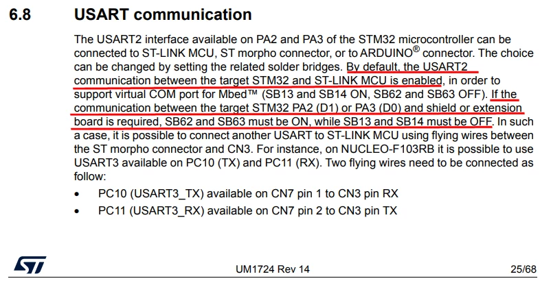

Jan 17, 2025 11:27 PM UTC
Well, it does say the following:
USART communication
The USART2 interface available on PA2 and PA3 of the STM32 microcontroller can be
connected to ST-LINK MCU, ST morpho connector, or to ARDUINO® connector
It most certainly is configurable, I'm just missing something.
Andrew Neil
Jan 21, 2025 11:08 AM UTC
and it does go on to say that by default the connection is enabled:

Jan 18, 2025 8:58 AM UTC
Ok, it seems the pins are used for serial connection with my PC over STLink... I will try different pins.
