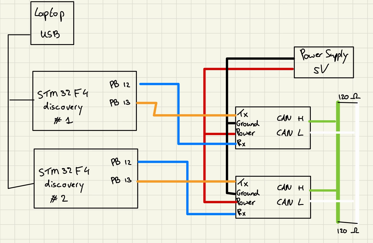

Two STM32F4-discovery boards unable to communicate over CAN
I am new to HAL libraries and currently working on a small CAN bus consisting of two STM32F4-discovery boards connected to a CAN transceiver connected to the bus. Both transceivers are externally powered with 5V.
So far, I tried the existing CAN examples from the STM32CubeF4 github. The loopback example works fine, the normal mode example does not.

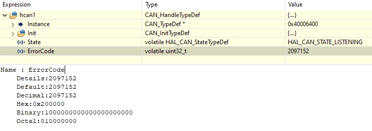

After a few transmissions the mailboxes are filled and the transmit function returns an error. And I can't figure out why it does not transmit the requests. Below you can find the code I on both discovery boards. It is basically the Networking example but with some light adjustments for LED output pins.
Any ideas on why this might not be working as expected?
How exactly? Aren't the pins used for this connected to some on-board circuitry, too?
Observe CAN registers content and waveforms on the pins and on bus.

That's only the case for CAN1, so I am using CAN2 on pins PB12 & PB13.
I also have an oscilloscope on the CAN-bus, which shows approx. 2.5V on both lines.

Are you using hardware transceivers?
After how many, always the same number? is that number 3?
hit me up in https://www.linkedin.com/in/javiermuñoz/
Rde K.1
Rde K.1Author
Dec 21, 2022 4:14 PM UTC
Yes, this is always the same number. After 32 messages, this errorcode occurs in the can handler.

How are the CAN transceivers connected to the dev board and to the CAN bus? Are the terminating resistors enabled?

You need a ground reference connected from the PS/CAN transceivers to the Discovery board.

Other points to check :
  • What is the voltage level of VIO pin of your transceiver TJA1051T/3? From the datasheet page 8: VIH min = 0.7xVIO. So if VIO = 5V. VIHmin = 5Vx0.7 = 3.5V! But your STM32 VDD= 3.3V < 3.6V!
  • Try to minimize the CAN prescaler value (.Prescaler) and maximize as much as possible the values of TimeSeg1 and TimeSeg2 and keeping your exact bitrate.

Firstly, please confirm the connection of the two boards, it seems ok regarding your diagram.
Secondly, it's necessary to combine these two boards' GND(seems ok).
Then the direct way is to capture the signal through a oscilloscope: TX(1st tranciever) = > CAN H/L = > RX(2nd tranciever).
