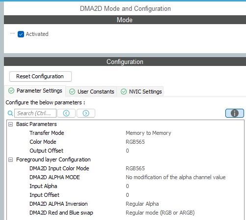

If I simple enable DMA2D in MX with my current project without making any code changes like this :

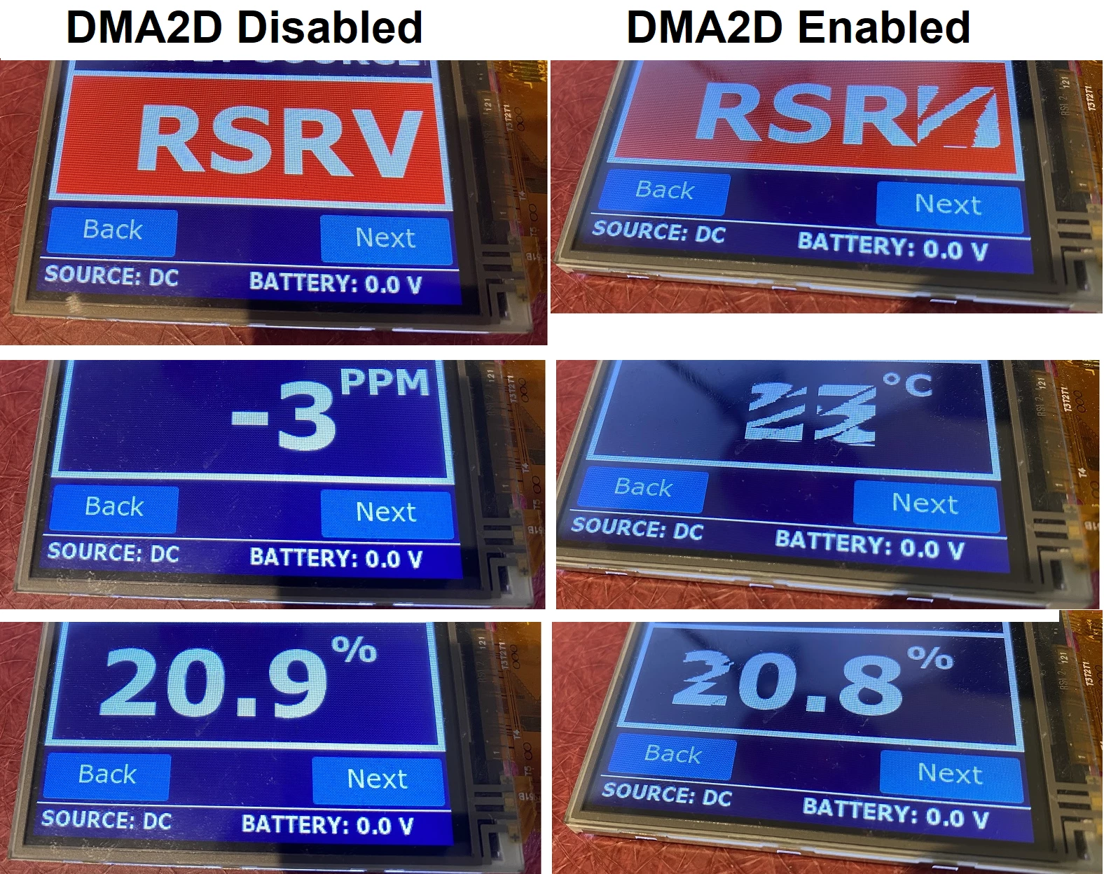

Then I get weird distortions on some of my text:

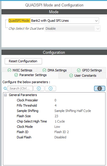

It appears that this problem was closely related to my other issue Re: Weird horizontal artifacts in touchGFX buttons - Page 4 - STMicroelectronics Community
As best I can tell, fast reads (using DMA) from my external quadspi-connected flash memory (in this case an MT25QL128 flash memory) were occasionally returning the wrong byte due to some bad settings in quadspi configuration (again, see link above).
Specifically what seemed to fix it was changing my clock prescaler to 0 from 2 (running the quadspi flash at a full clock speed of 80MHz) and changing the sample shifting to half-cycle. I realize that this is not a fully satisfactory answer, as increasing clock speed should not make signal integrity issues improve generally, but it is best I have for the moment, and hopefully if someone comes across this later, it will at least point them towards where to take a closer look.

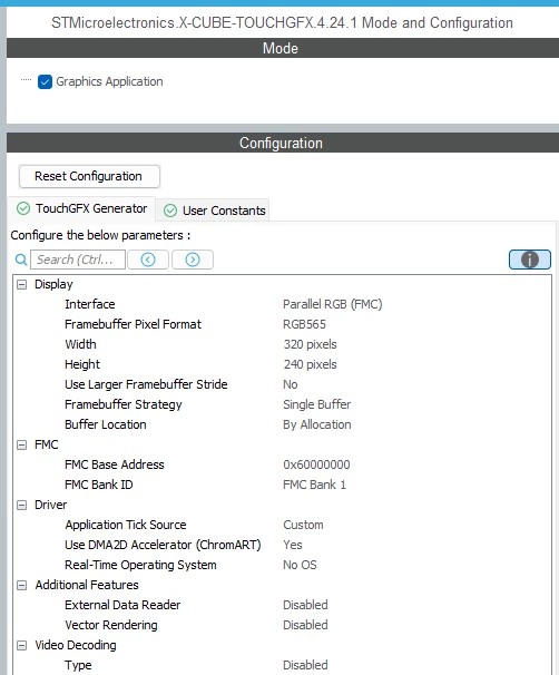

Two additional observations:
1. The character distortion appears to go away when I shrink the font down to about 60 (currently its at 80)
2. If I set the option 'Use DMA2D Accelerator (Chrom-Art)' within the touchGFX settings in MX to 'No' but leave everything else the same (including leaving DMA2D enabled), the problem also goes away, though I suppose this is not surprising.
