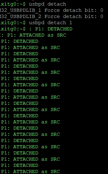

RHelv.1
RHelv.1Author
Apr 6, 2023 9:28 PM UTC
@nicolas P​ Thank you for this code and ongoing support. After testing it, when I force the Detach, instead the USBPD code oscillates between Attached and Detached. I've attached my usbpd_cad_hw_if.c file for you to review.
Specifically, I'm unsure where in the CAD_StateMachine_DRP function (not SRC) I need to make edits, and also if the else clause in ManageStateAttached_SRC was implemented properly.
Thank you,
Rob
Dominique
DominiqueBest answer
Apr 7, 2023 8:08 AM UTC
Hello @RHelv.1​
I checked you file and if your application is using DRP state machine you need to apply following fix to avoid a new attachment
line 854 of your files
case USBPD_CAD_STATE_SWITCH_TO_SRC:
 case USBPD_CAD_STATE_SWITCH_TO_SNK:
 /* patch force detach */
 if( _handle->ForceSRCDetach == USBPD_TRUE)
 _timing = CAD_INFINITE;
 else
 LL_UCPD_RxDisable(Ports[PortNum].husbpd);
 if (USBPD_CAD_STATE_SWITCH_TO_SRC == _handle->cstate)
 USBPDM1_AssertRp(PortNum);
 Ports[PortNum].params->PE_PowerRole = USBPD_PORTPOWERROLE_SRC;
 Ports[PortNum].params->PE_DataRole = USBPD_PORTDATAROLE_DFP;
 _timing = Ports[PortNum].settings->CAD_SRCToggleTime;
 if (USBPD_CAD_STATE_SWITCH_TO_SNK == _handle->cstate)
 USBPDM1_AssertRd(PortNum);
 Ports[PortNum].params->PE_PowerRole = USBPD_PORTPOWERROLE_SNK;
 Ports[PortNum].params->PE_DataRole = USBPD_PORTDATAROLE_UFP;
 _timing = Ports[PortNum].settings->CAD_SNKToggleTime;
 _handle->CAD_tToggle_start = HAL_GetTick();
 _handle->cstate = USBPD_CAD_STATE_DETACHED;
 break;
This patch is not perfect because it doesn't allow switching to SNK case (which could be interesting for a DRP requiring power). But you can easily allow the execution of the sink part in ForceSRCDetach case.
BR
Dominique
RHelv.1
RHelv.1Author
Apr 10, 2023 3:40 PM UTC
Thank you @Dominique​ . I have this working. Much appreciated.
Rob
