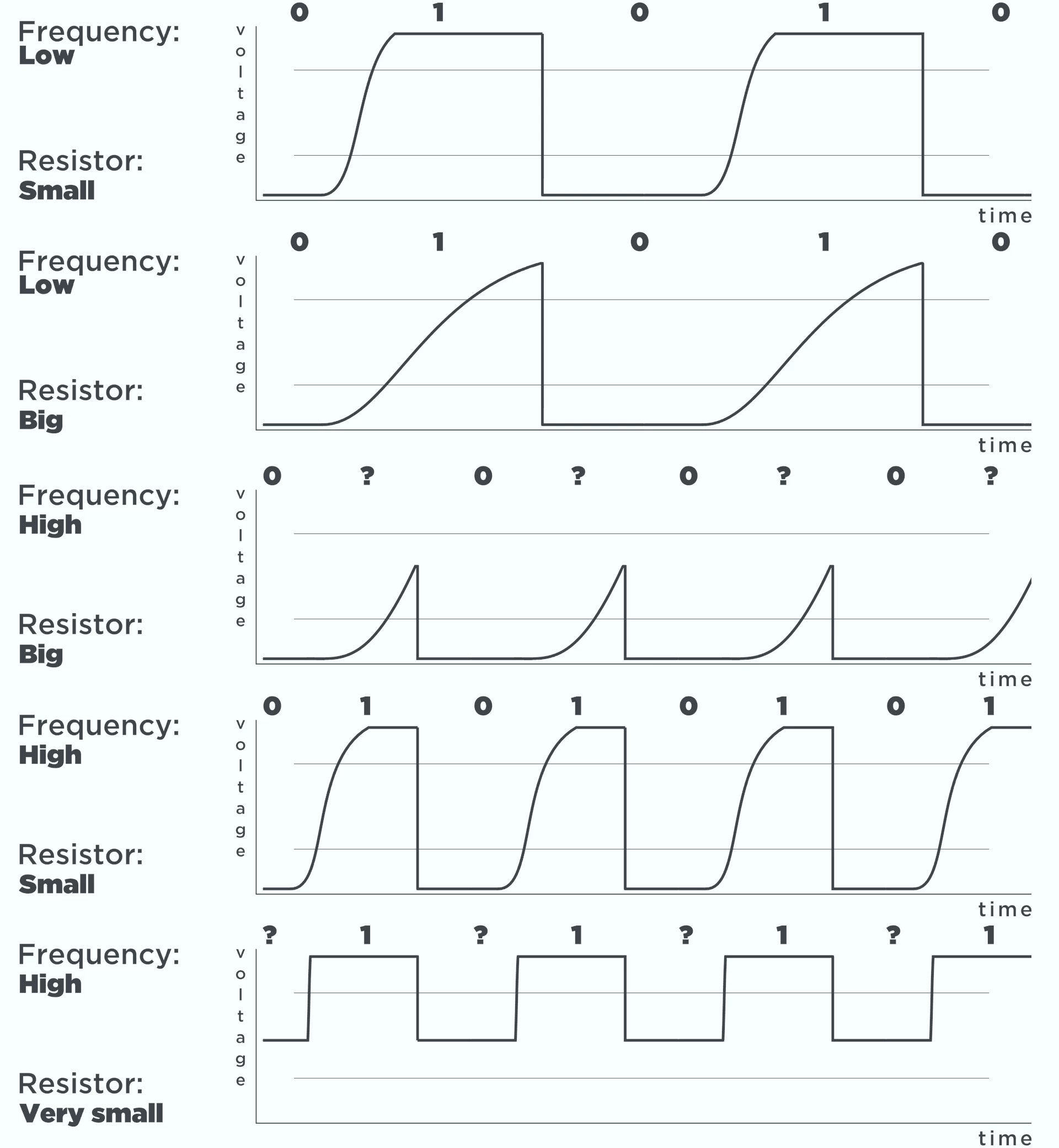

You'll also want something that can show you what's happening in the analogue domain.
In particular, that will show if your pullups are correct:
See: https://electronics.stackexchange.com/a/473799
timbo2023Author
Mar 24, 2025 11:27 AM UTC
I do not understand...
Andrew Neil
Mar 24, 2025 12:49 PM UTC
A logic analyser will only show you 0/1 logic levels - so it assumes that your signal is clean & correct in the analogue domain.
If you've got "analogue" problems (such as missing/incorrect pullups on I2C), a logic analyser isn't going to help.
