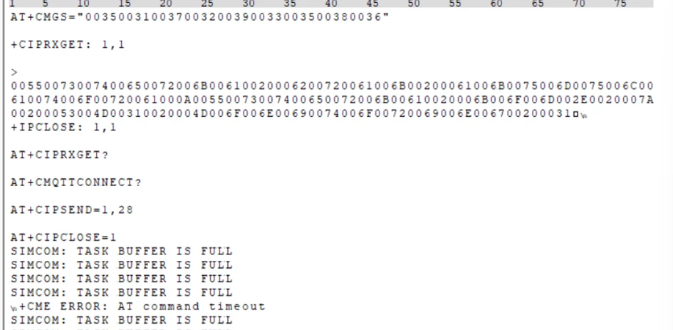

Could anyone explain me why when I try to transmit data by UART using DMA in IDLE interrupt  function from receive DMA on the same UART working in circular mode, once in several attempts my reception lost some data? TX and RX use different channels of DMA.
When I change Trasmit_DMA to casual Transmit in work even though the interrupt handling takes more time.

No, transmission use another buffer thar reception. I can add that receive buffer is a circular buffer where data is received by DMA in circular mode and parsed in IDLE interrupt to ensure that received a full message.
It's AT command communication where I look for expected response or incoming command, parse that, move the tail and send the next command from another buffer.

Yeah, I know that it's quite a lot of operations in interrupt handler, but it works if I transmit without DMA when it takes more time.
I should get response from my modem after every command I send. For example I send command to set baudrate AT+IPR=115000 and get OK, wen I send SMS by AT+CMGS="AAAA" and I get +CMGS: 4 and OK.
So once in a while when I send for example CMGS I don't receive response. I'm sure it is send by simcom because before using IDLE interrupt I hadn't had that problem.  I've checked the receive DMA buffer and the message is really not there.
And it works when I turn off DMA on transmission.

That you (and by "you" I mean the program in 'G4) don't receive "OK" from modem may mean also that the modem hasn't received your query (i.e. you did not transmit it or did not transmit it completely). You should be logging/sniffing both lines using e.g. a UART/USB converter and a terminal program in PC (or if you want to get fancy, using a LA or oscilloscope capable of decoding UART) to see what really happens. I suspect, the latter (i.e. you don't transmit properly).
Is the cascade in the Rx interrupt the *only* place from where transmission/Tx DMA is initiated?

Thanks, it may be true and I don't know why I didn't think of that. Here is the example of error. In fact now I see that if that message had been sent the modem would not have been blocked because it's all data it need to response. Below there is CME ERROR from modem which tell that message was correctly handled.
Unfortunately, I don't currently have a soldering iron on hand to connect directly to the line.

Data are transmitted also in main loop if there is defined delay in sending command but the code is written to send simultaneously only one message, wait for response and then send next. Also every RX and TX message is forwarded to debug uart which print screen is visible above.
Could the cause be that RX dma has higher priority than TX and as visible on print screen in time of sending data in SMS there is another incoming message +IPCLOSE which  break transmission?

I can add that I have replaced DMA channel with TX of another UART and not it seems to work correctly. RX and TX on one UART use not only different DMA channels but different DMA.
